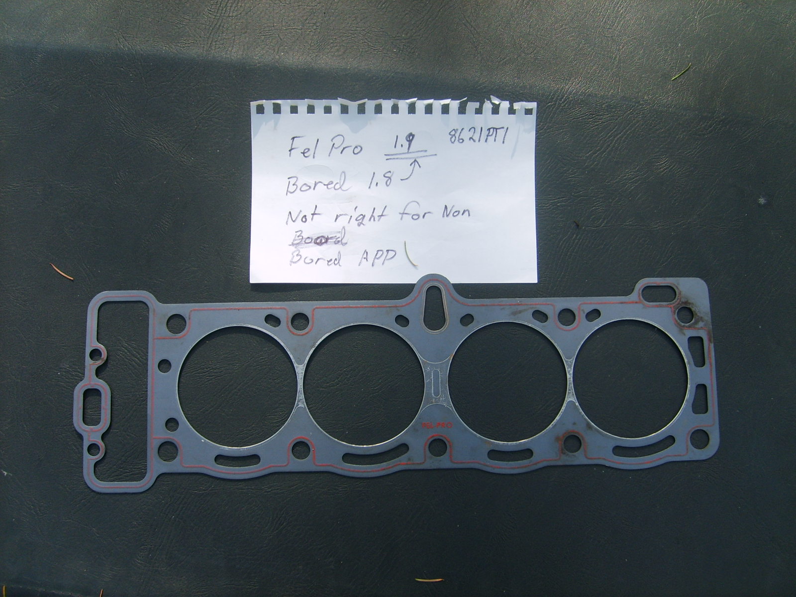

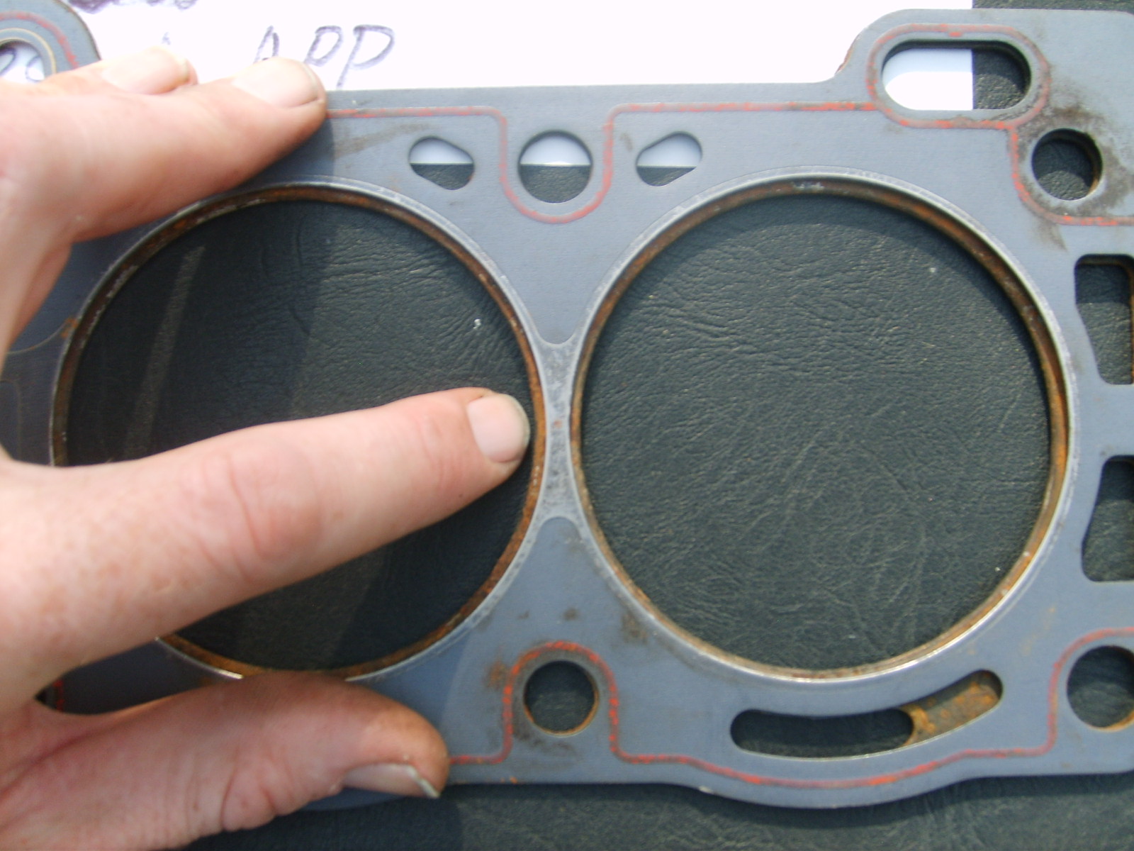

ok guys i have found something with felpro its a bored out 1.8 gasket i found the correct head gasket posting pic right now
File comment: ok my finger is on the 2 gaskets felpro is on top and other under see the thickness felpro burn in that spot on 1.8 they need two make 2 or 3 different gaskets for this engine oh and look at the water jacket see that also week spot to me on felpro

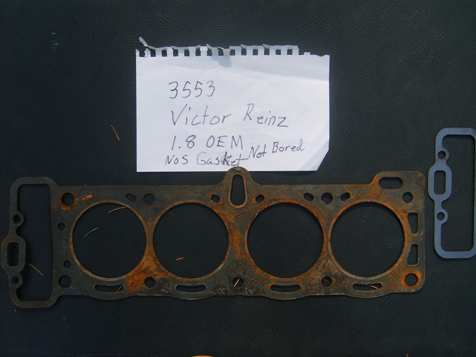

File comment: this is the part num you will need
3553 victor reinz gasket. this on in pic is oem i went to carquest and had a new on in my hand same everything holes and water jacket

Hmmm, I just bought a Felpro just like that one. Hope it works for me... 8O
