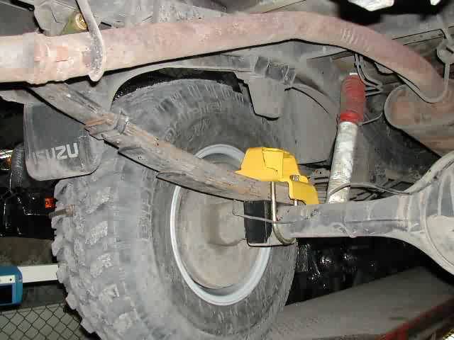

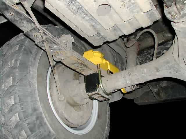

This is how i plan to lift the rear of my Luv, all parts bolt in. No cutting or welding, easily reversable.

So the shocks bolt to the SOA bracketry...I like that. Where can I find those brackets that are in the pics? Those would make things hella easy. What about brake lines and such? Any thing else need to be modified?

i will get some pics tomorrow... basically you take and put the spring pads on top, put the pads on the opposite side them came off and bolt it all back together as i recall.... depends on how your shocks are mounted though... looking at that picture i might have a different setup on my luv trailer.... :?
EDIT:
found an old pic form when i first got one of the luvs, i didnt do this, but it looks the same as the way i did mine....
make sure to WELD those black pieces in... I had a set on my S-10 and had the metal they rest on fatigue and fold under the axle wrap/torque :evil:
EDIT:
I was wondering if I had to buy some other stuff; or if I could just use what's under there already. That is what I wanted to know. I guess I will have to look at the shocks. Thanks Boonie Buster. I think that this is more of what I want to do. You can post some pics of what you have also though.

Remember you're not supposed to re-use U-bolts...so you might buy new ones
You got it. Any recommendations...or just whatever?

Well if you find some that are designated as axle u-bolts that will fit in terms of axle tube diameter and length...I would say you can use them. The auto parts store sometimes has them, a 4x4 truck store will definitely have them, and if all else fails there's always Summit Racing. It's like bolts, I think you need appropriate tensile strength, e.g. Grade 8 if it were a bolt; you can see in the pics from OzLuvTrucker that they are a golden color, that's the color Grade 8 bolts usually are. But any u-bolt from a reputable suspension company (Skyjacker, Rancho, Superlift, Warn, Moser, etc) should suffice.
At the risk of being lengthy in my reply, I feel new u-bolts are in order first of all because if the old ones were overtorqued at all previously they are now stretched and so cannot be reused (they won't torque up properly); and also since you are putting lift in your truck you might go with bigger tires later, which increases unsprung weight and means you might want the piece of mind of having new axle attaching hardware. My 0.02, and how I'd do it if I were doing a spring over.
EDIT:
I'm actually in the process of doing this. I pulled everything off today, and now I'm curious... How, in this picture, are you preventing axle wrap? Is that block in between you axle and your leaves cut to a half-moon and welded in?

I'm not preventing axle wrap in any way... that's another topic here :wink: I can't remember if on my setup if i had to weld new perches on or not..... it's been years since i put it together... :oops: If you do, no biggy, go to your local offroad shop and get some weld on perches and go for it!
