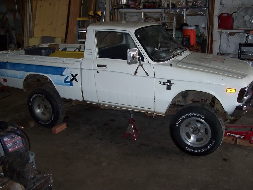

i've been a member for a while but don't post much. i finally got my project started afew weeks ago and thought you guys might like to see some pics. 3/4 ton 10 bolt front, 14 bolt rear, stock motor & tranny, soon to have divorced toyota t case w/ 4.7 to 1, and full hydro steering

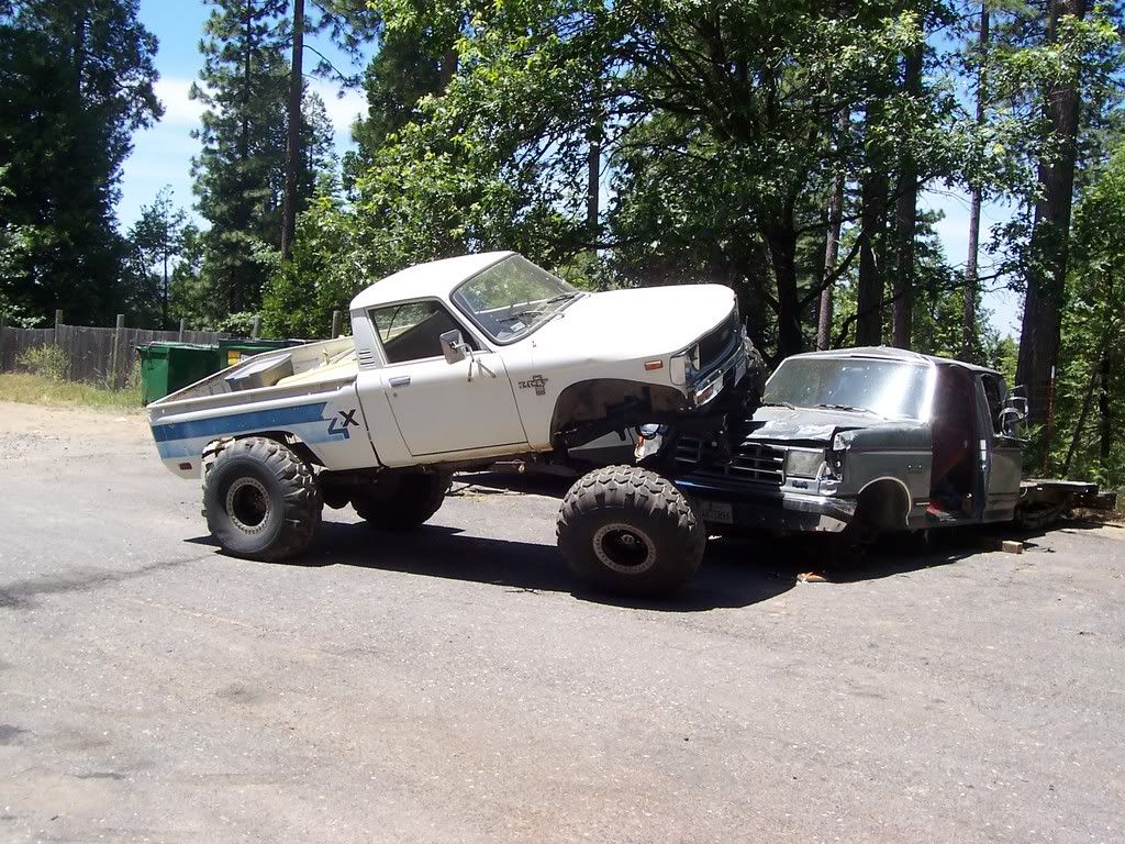

NIce truck!!!! Thats a lot of travel you got there esp on a LUV!!!! Dont mess that front bumper up rock crawling, looks pretty straight and that is a rarity nowdays and whats up with the yellow doors in the bed???

nice flex!!! I like that half door idea cant wait to see how that turns out.

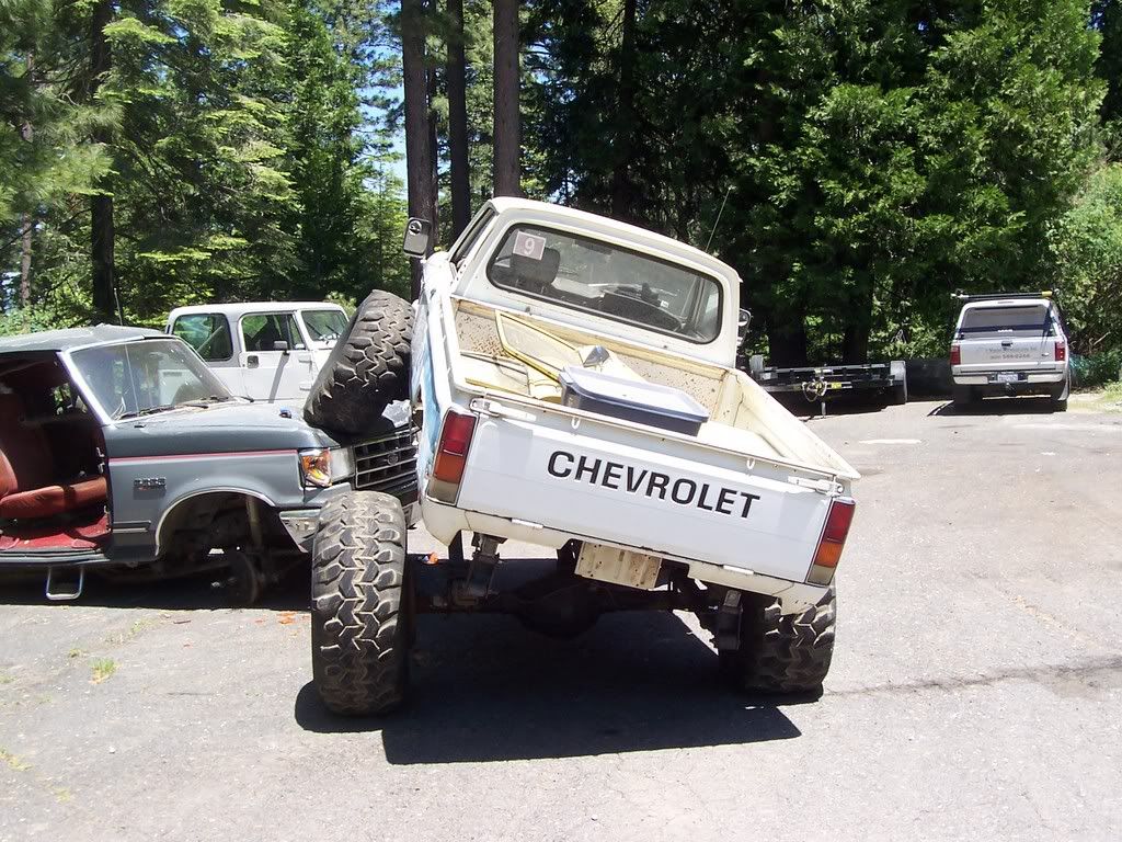

That's a nice lookin' ride man. looks like i have some competition up in here :lol: so what springs are you using, i see you're using a revolving shackle up front. looks good 8)

i'm up in the mountains about 2 1/2 hours south of tahoe. i'm just using junk i have laying around for the suspension. fronts are wagoneer and the rear in the picks are stock luv. i have some dodge main leafs that i built with wagoneer leaves that will be going in tomarrow. i'll probably end up checking spings and take the revolevers out of the front. it would have flexed more but the tires hit the fenders. thanks for all the responses.

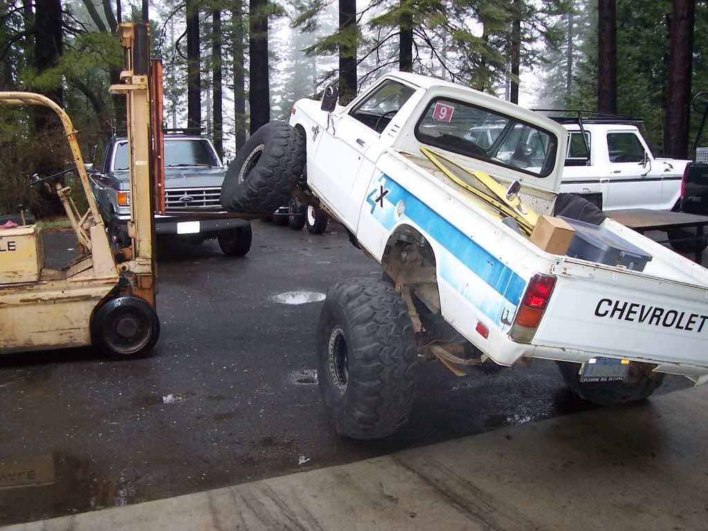

and a fork lift too?

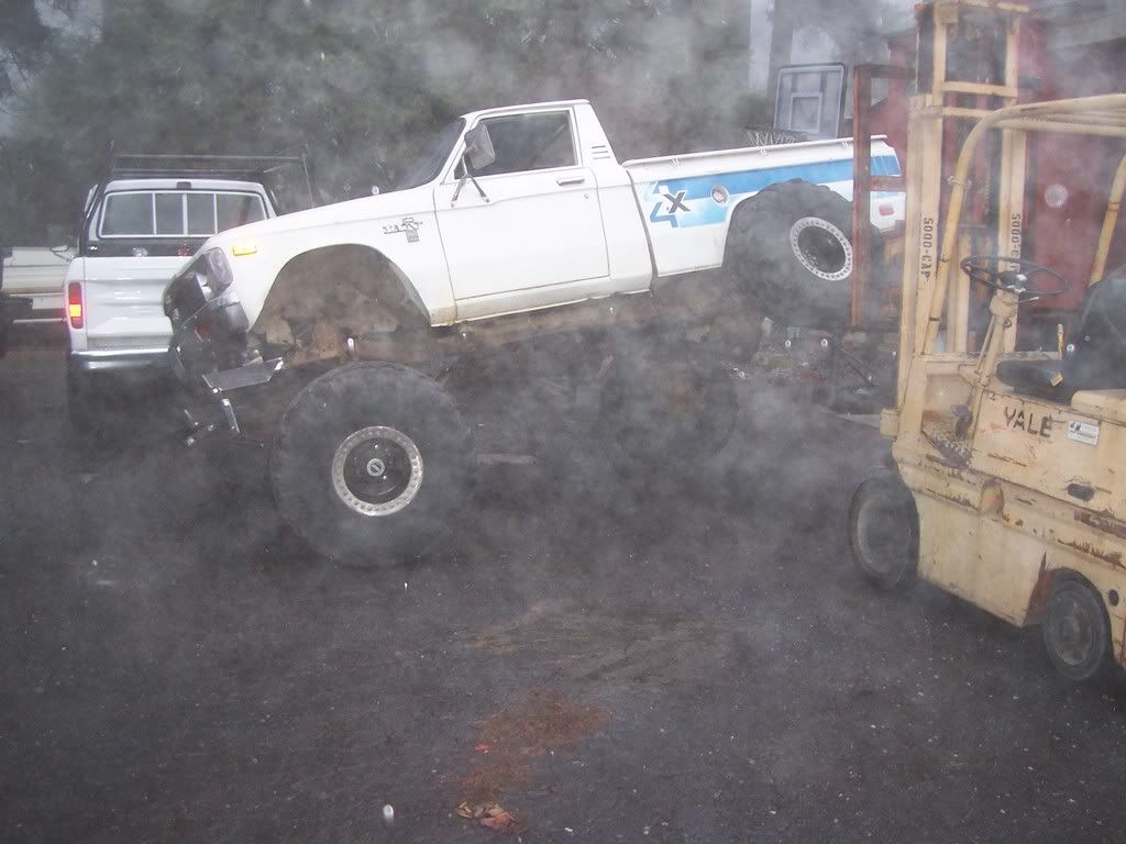

finally made some visible progress. still just poser pics but atleast i drove it to take the pics. as soon as the cage is done i'll post some trail pics!
still waggy front springs, but 63" chevy's in the rear. need to mount shocks, seats, and build the cage.

Why did you go with a 10 bolt front? Seems like a waste of time when paired with a 14 bolt rear? Wouldn't the waggy front spring be a little too stiff for that light of a truck? Also, be careful with those revolvers. They tend to unload at unexpected times.
Looks good though. Flex is nice. What gears?
