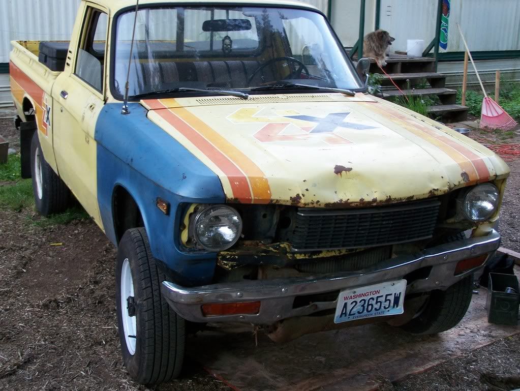

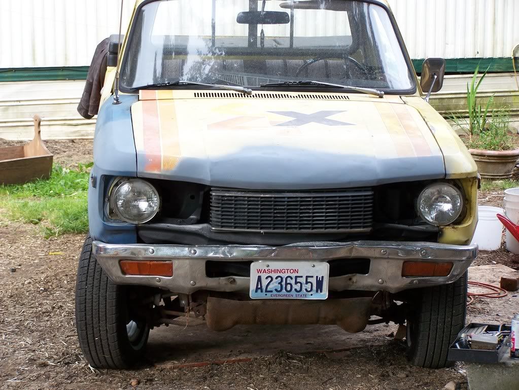

Here are before and after pics of the front end:
I know it's not pretty. I will eventually be looking for a new hood and bumper before doing the $50 paint job I read about here.
