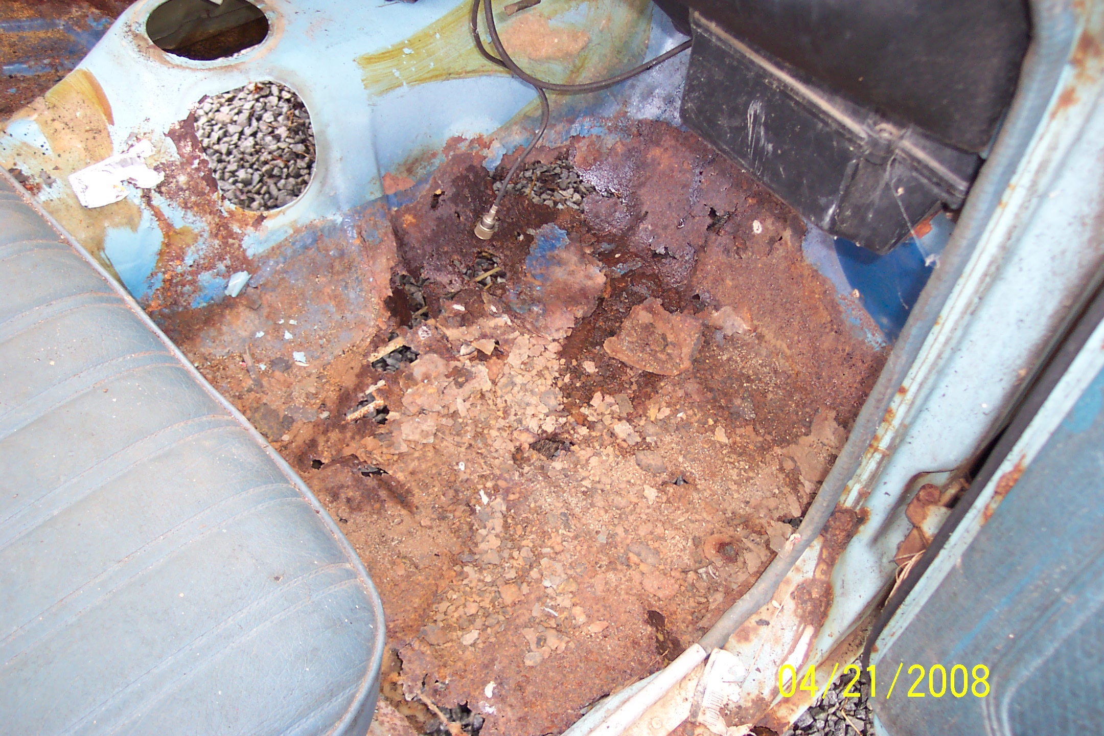

My 80 has contracted a case of cancer in the floor pans I was wondering if anyone makes replacement floor pans and body panels for LUV's?

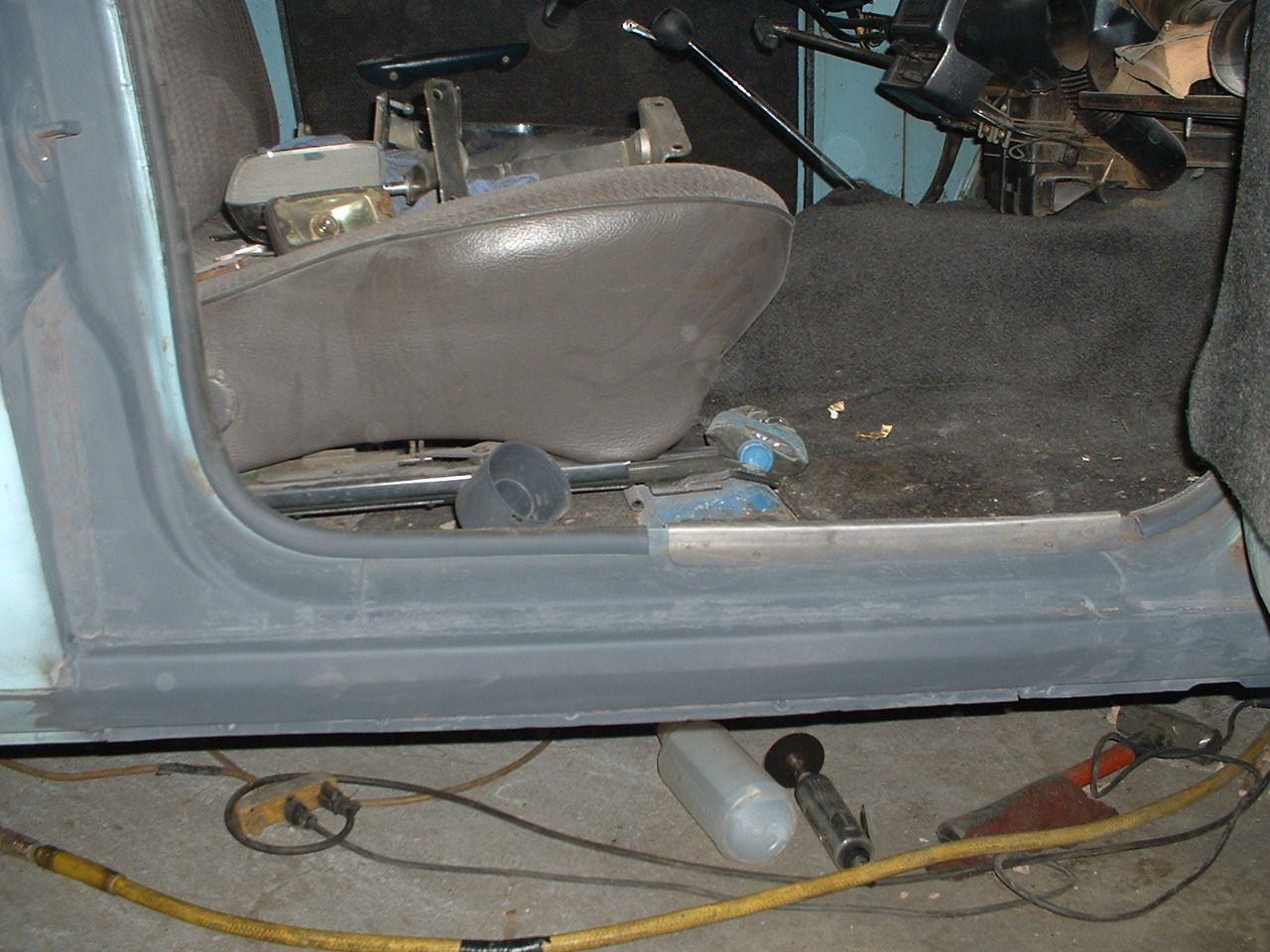

best bet is to find a new cab or cut some out of a parts vehicle and weld them in a tip for welding them in is to tact corners but after each tact weld have a bucket of water with a sponge and get it damp and cool it right away wont warp its a long process but if done turns out nice I have filled in marker lights and made a new rocker panel

tumwatertaz wrote:
Or clean them up, use a little rust preventive on them, and just fiberglass them. I put webbing and resin (two coats) on the underside and on the inside of mine and they are strong as the dickens. Just make sure you spray a litle primer and paint on both sides when you are done. It's a lot easier than welding new sheet metal in and they'll never rust or leak again.
Taz, that sounds like a good option on rusted floors. How clean do you need to get the rusted floor? As you can see in endless expenses' pic there is a lot of loose rust as well as not so loose rust. What method did you use to clean yours, sanding, brushing or blasting? Also what type of rust preventative did you use and what is the function (to remove or to cover/bond)
endless, don't mean to highjack your post, please excuse.

By all means,the more information the better!Problem I see is there is not that much floor left!All the loose rust is gone now I posted the wrong pic.Me and the shopvac pretty much removed the whole floor pan!Looks like some custom fab work is in order :D
