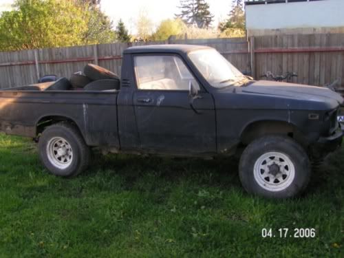

Imagegood old washington mud
Imagesoon ill be restoring it
Imagethe zuz
i just bought this bad boy for $400. no lift 28" tires, the engine runs great, my trannys soon to shit the bed, bodys 1 million dif colors, little bit of rust, bed is %70 good. I plan on rebuilding tranny and engine this summer, and doing some body work and fresh paint, 2" body lift. when people ask how it drives, i tell them its like driving a go kart with bad alignment---haha the old ball n chain has a jeep with 33's, this thing went everywhere she did and more, this is the 5th 4x4 ive owned from toyota to dodge, and so far im most impressed with its capabilities. what gear ratio in the rear, i heard 4.10 but that seems to bad ass, is it true?
