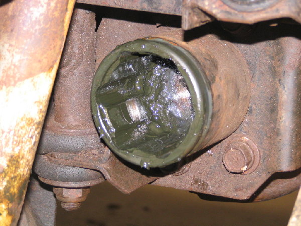

Can't find the link so i'll do a brief how to.
1. Place truck on jack stands and remove wheel
2. Remove locking hub and take off cv shaft retaining circlip.
3. Undo two bolts holding brake caliper , remove and tie up out of way.
4. Release Top and Bottom ball joints and remove spindle/rotor.
5. Peel back boot on inner cv joint and remove wire retaining ring (see pic below
6. Cv shaft should now pull out of cup, replace with new.
No need to drop front pumpkin/axel assy unless pictured cup is badly damaged.
1980 4x4 KBD40 ISUZU/Chev Luv

Dang... lol, with 198,000 miles on the truck, it sounds to be about time for the CV's to be replaced/rebuilt. Does anyone know where I could get the bearings from? And, because the cup is a wear surface, wouldn't that present problems with the new bearings wearing incorrectly?
Thanks for the directions Oz. I'll try that first.
Oh, and how can you tell whether or not the cups are too worn?
 Post subject: Re: CV AXLE
PostPosted: Wed Dec 09, 2009 7:06 pm
Posts: 1387
Location: Great Falls, MT
I haven't had to replace the ones in my Luv but I have replaced some in other vehicles. I haven't had to replace a cup yet. I inspect mine to make sure where the berings ride inside the cup still has a definitive line and isn't rounded out. (it would have had to slip to do that or have been SEVERELY/DANGEROUSLY worn). The pic that OZ posted looks good from the pic. Look for any other damage like cracks, pits and any other thing that doesn't look normal. Make sure there isn't to much play in and out or up and down with the cup either. I'm sure my time is coming for my Luv as well.
