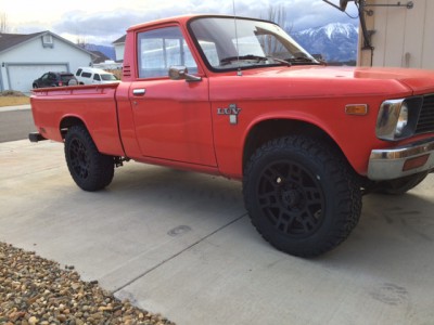

Ok will do. I just installed 225/65/17 they were supposed to be 29in but I just measured them at 27 3/4. I am glad they are only 27 3/4 if they were any bigger I would really have a problem with the front fenders. Fenders need a little trimming as is.

Before you do much fender trimming you might want to consider lifting the truck, it will lessen rubbing. Turn the T-bars 1-revolution per 1/4" lift to raise the front, add a leaf to the rear, get an alignment afterwards. 3" or more lift is possible, ride quality degrades with lift, especially over 2"
