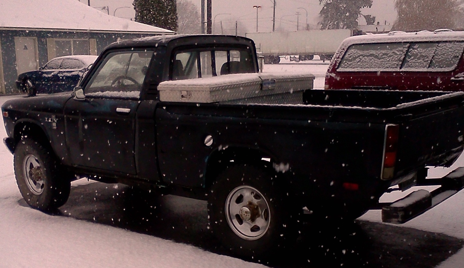

Tell you what. I'll get pictures up of mine within the next few days, and some tonight, with it's 33's on, and I'll get as detailed in the later shots as I can get... so maybe you can pick up some ideas from it too. That way you might get a better idea .... sound good? Also, if I can figure out any technical details to assist you in the process I'll be more than happy to share...
I did do some looking, it has a 2 or 3" body lift, a 2 inch suspension lift and air shocks out back and they are 33x12/15 tires on some what looks like mitsubishi mighty max rims...... the front has heavy duty truck shocks... but I'll get some detailed pics like I said later this weekend if that will help.
Just no jokes about the crappy rattle can paint job... that wasn't my doing lol

In fact the front has been cut but not the back. The very lowest part up front has been cut across from front to back, about 2 or 3 inches of it, and the edge tapered for a little extra clearance. The rear of the fender was rounded off at the wheel well for the same purpose. It still comes very close but doesn't rub under most uses, I haven't gone crazy with it yet though. Running behind on getting those pics to you, but I will... just bear with me... been wicked busy.

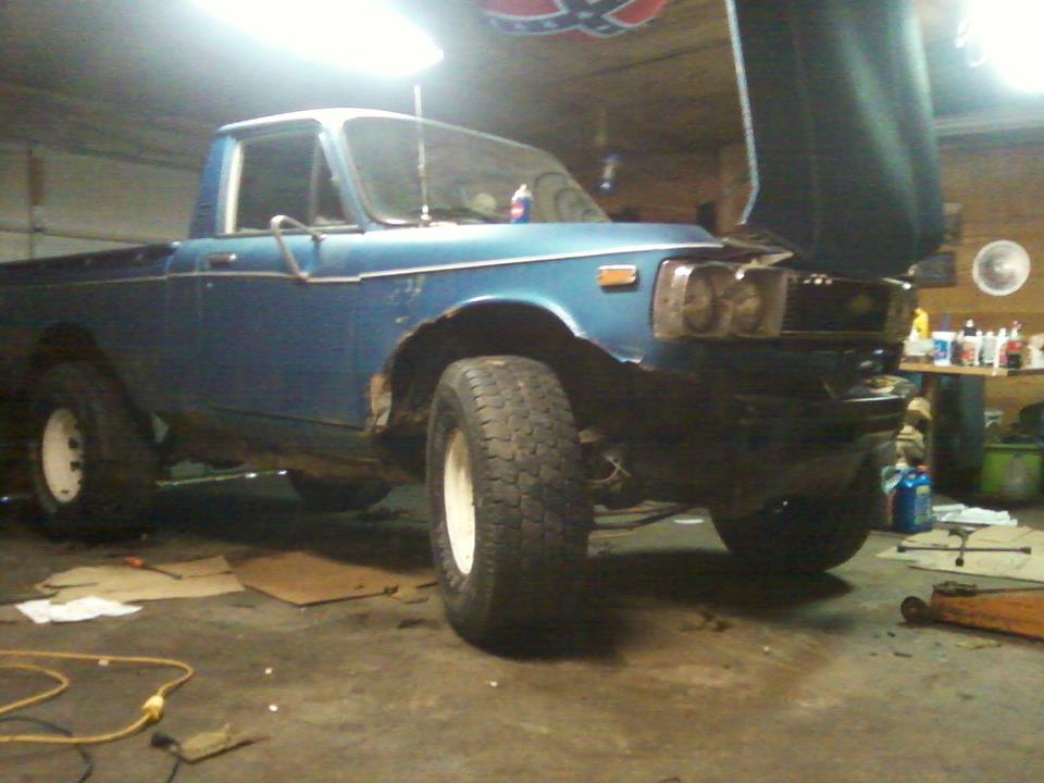

well my luv had 33x14.50x15 thornburgs on it wen i bought it but the guy wanted to keep the tires but he had cut the fenders to get them to fit and it has a 3 or 4 inc body lift so they will fit but idk if they rubbed or not and it has the stock 1.8l he said it didnt have a problem pulling them i have 33x12.50s on it now and they clear perfectly
