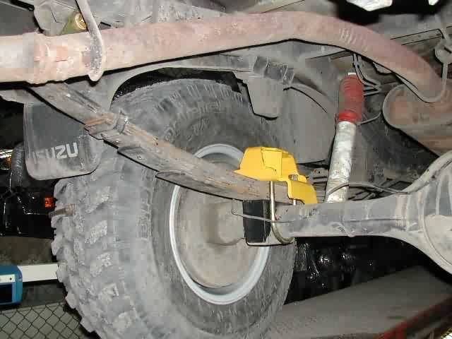

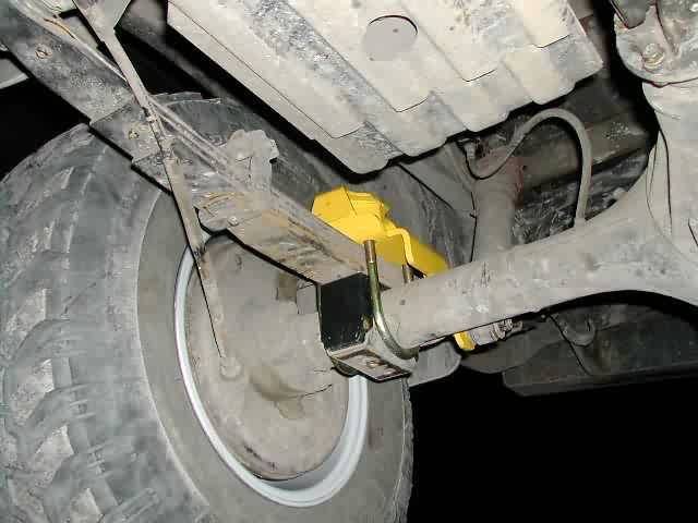

This is how i plan to lift the rear of my Luv, all parts bolt in. No cutting or welding, easily reversable.

So the shocks bolt to the SOA bracketry...I like that. Where can I find those brackets that are in the pics? Those would make things hella easy. What about brake lines and such? Any thing else need to be modified?
make sure to WELD those black pieces in... I had a set on my S-10 and had the metal they rest on fatigue and fold under the axle wrap/torque :evil:

Remember you're not supposed to re-use U-bolts...so you might buy new ones
You got it. Any recommendations...or just whatever?

Well if you find some that are designated as axle u-bolts that will fit in terms of axle tube diameter and length...I would say you can use them. The auto parts store sometimes has them, a 4x4 truck store will definitely have them, and if all else fails there's always Summit Racing. It's like bolts, I think you need appropriate tensile strength, e.g. Grade 8 if it were a bolt; you can see in the pics from OzLuvTrucker that they are a golden color, that's the color Grade 8 bolts usually are. But any u-bolt from a reputable suspension company (Skyjacker, Rancho, Superlift, Warn, Moser, etc) should suffice.
At the risk of being lengthy in my reply, I feel new u-bolts are in order first of all because if the old ones were overtorqued at all previously they are now stretched and so cannot be reused (they won't torque up properly); and also since you are putting lift in your truck you might go with bigger tires later, which increases unsprung weight and means you might want the piece of mind of having new axle attaching hardware. My 0.02, and how I'd do it if I were doing a spring over.
