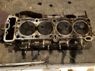

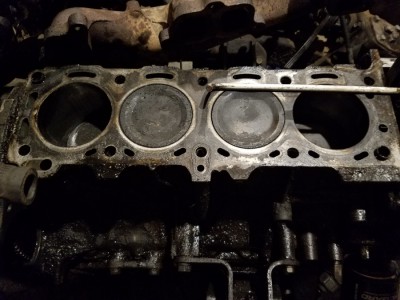

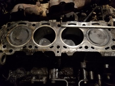

The other night (Tuesday night), I pulled the head off of the motor to check out the valves. other than needing a really good cleaning, everything looks to be in good shape. I am going to try and finish pulling the motor (im was impatient and wanted to see how the cylinder walls and valves looked) tonight and do a massive clean on it.
