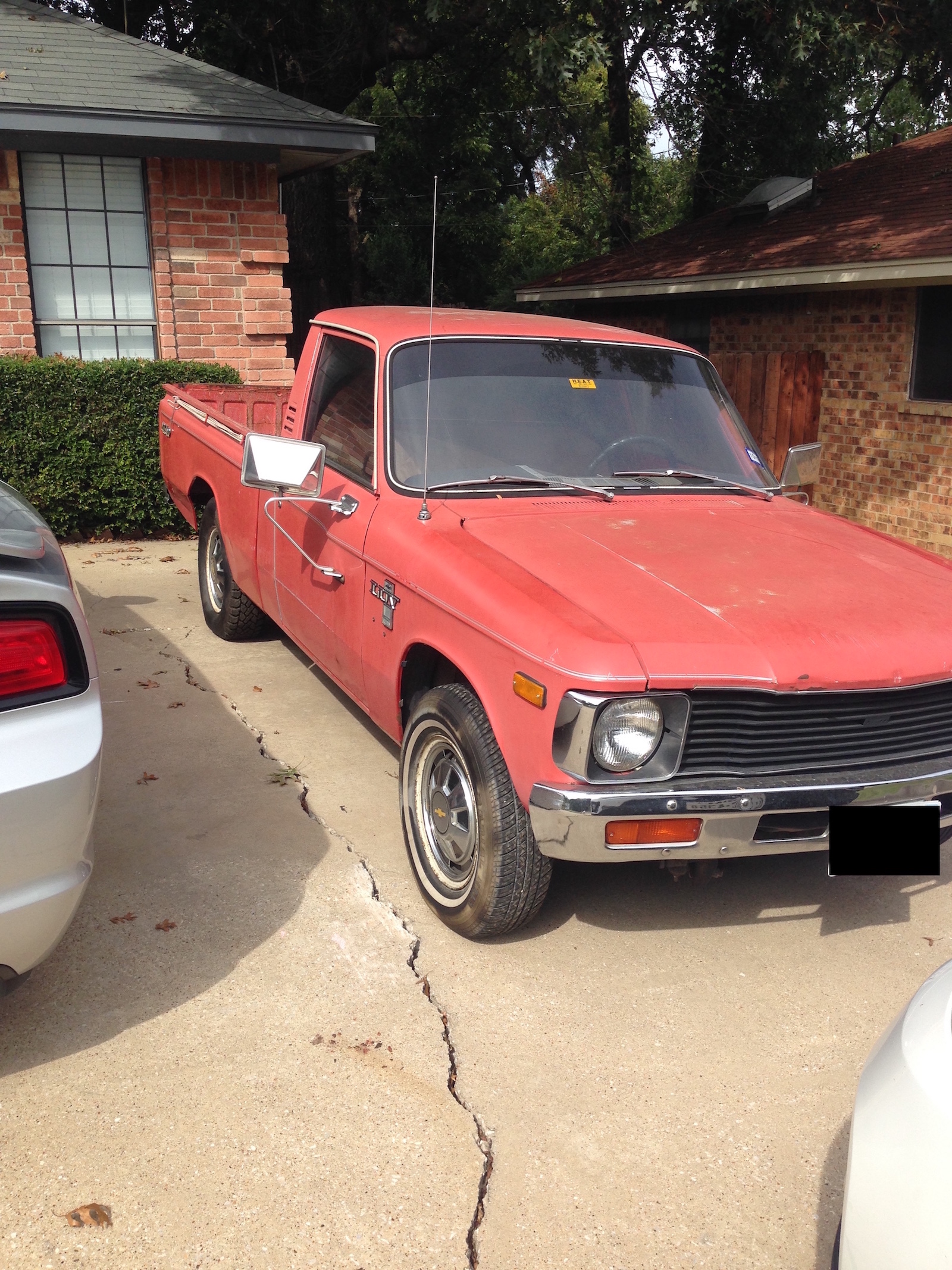

I've been wanting an old truck to fix up...out of the blue my brother-in-law gives me a 1980 Luv.
Was running about a week or so ago. Now it won't start up. Will turn over and only fires up with carb cleaner/starting fluid but won't stay on.
I've got my work cut out for me...I'm sure I'll be scouring the forum for answers.
