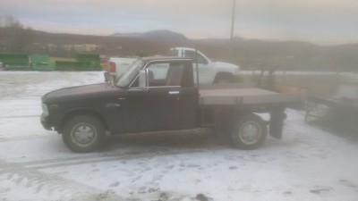

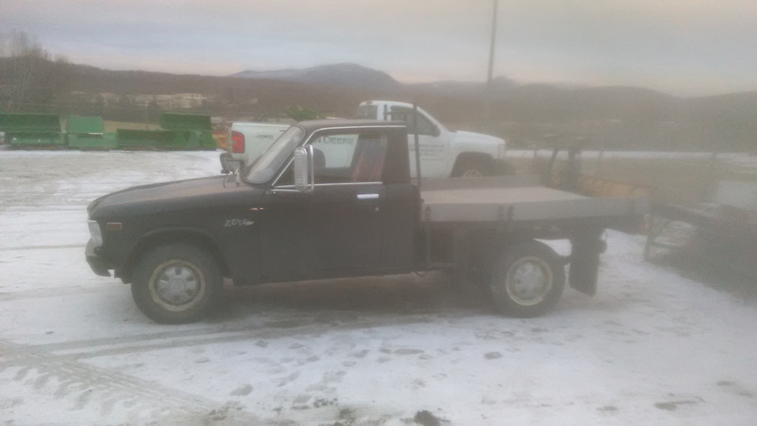

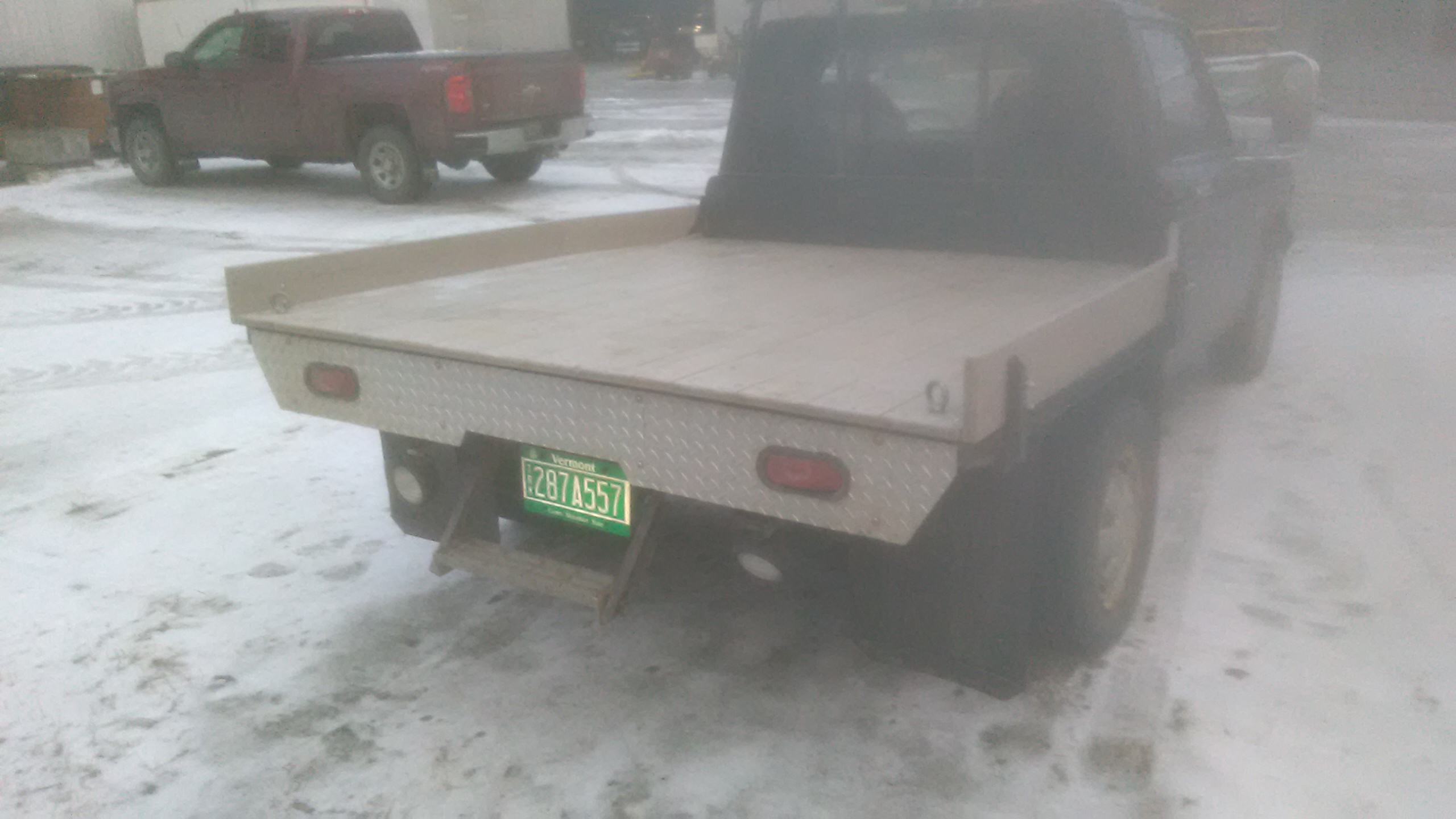

I had a 79 4x4 Mikado back before I was old enough to drive, sold/traded it off before I ever got my license. Just picked up a 1978 LUV flat bed dually 20 years later.
Has had a cheap teal paint job covering some rust, 231 Buick V6 and auto trans. Truck was originally auto so it looks at home. Factory produced steel flatbed. The dually conversion is unique in that it's all in the wheels. first wheel bolts onto the hub, second wheel bolts onto the first using seperate studs. I'll have more pics soon and will start a build thread. Plans are to get it running and rock it as is. Fixing rust issues as I go along of course.

I believe I saw this one on CL this weekend when i was out of town, if so, good price on it.

i like the dual rear wheels!

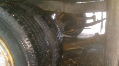

Here is a visual for how the dually conversion works. Any more pics, etc will be posted in a build thread.
Brakes are first on the list, it has none.

That's a common set up for the mini truck dually set up. Pretty much the same as the Toyotas.

Good to know more are out there. I searched the interwebs for pics but found none. All the conversions I've seen in person were big ol spacers that bolt between two stock wheels. I like this alot better but it's not as good as the full floater yota 1 ton camper/uhaul rear.
