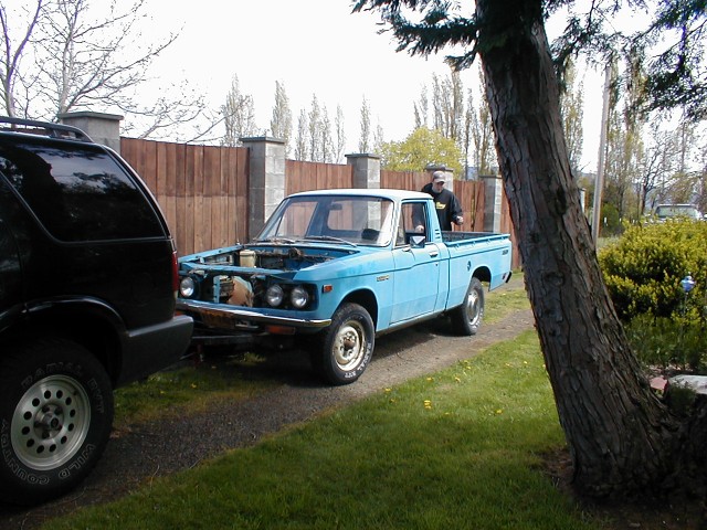

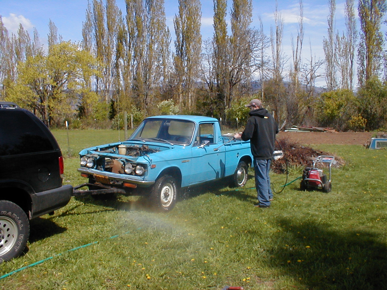

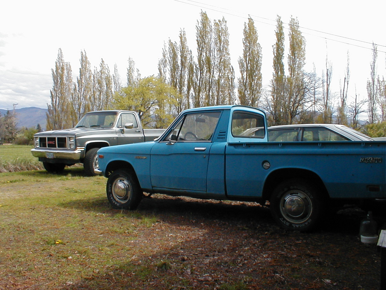

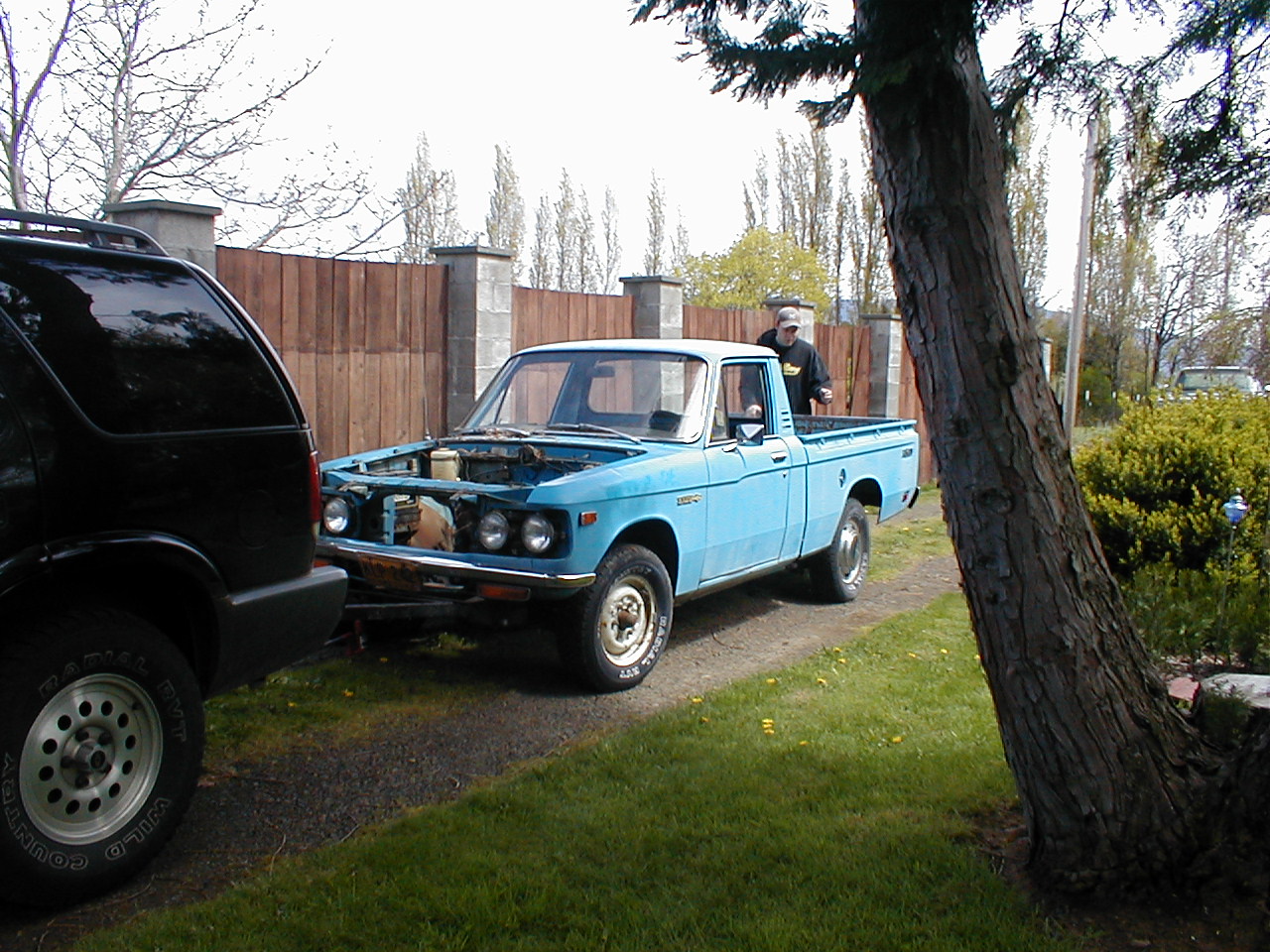

Here's a few of pictures of the Luv.
My wife & I purchased the Luv in 1991. It was a daily driver for about 10 years until it overheated for the last time and cracked the head or block?? Very hardy little truck. Replaced it with a 1986 GMC 4x4. Now it's time to bring the Luv back to life.
Ready to install 350/350 auto in Luv. Any suggestions? Have Hooker tranny & motor mounts. If the engine & tranny are connected and installed together, is there enough clearance to get them in the Luv. Is it better to install the tranny first then the engine. How much of the front needs to be cut away? Any advise will help.
Thanks

 Post subject: Re: Project '75 Blue LUV
PostPosted: Wed May 21, 2008 12:48 pm
Posts: 885
Location: Coburg, OR
There are a couple of links on the main page of this site that will be helpful. http://www.luvtruck.com/Information.htm
Beer budget V8 Swap http://www.luvtruck.com/pdf/engswap.pdf
Hooker Kit Instructions http://www.luvtruck.com/pdf/12606.pdf
You can download these in zip format also. If you want to keep the core support in tact, my understanding is that the truck needs to be close to 3 feet off the ground in order to get the engine/trans in as one piece. Another option would be a pit. You can also cut the core support loose from the front fenders and cut out the inner fenders altogether. The fenders hang fine from just the cab and the core support. Look for photos here of some of the V8 trucks, it will make more sense.
I'm not actually sure how folks have gotten their engines in. I'm sure you'll get more answers...
What do you plan to use for exhaust?
What are your plans for HP?
Street truck or 1/4 miler?
You may want to look at upgrading the brakes too... :ebiggrin
Your truck looks really solid, have fun!
PostPosted: Wed May 21, 2008 2:33 pm
There is plenty of room. I installed my motor and trans as 1 unit and have a full stock core support. I only had my front tires maybee 6 inchs off of the ground.

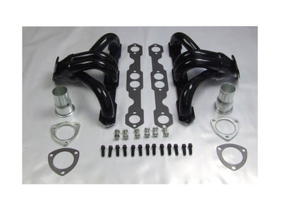

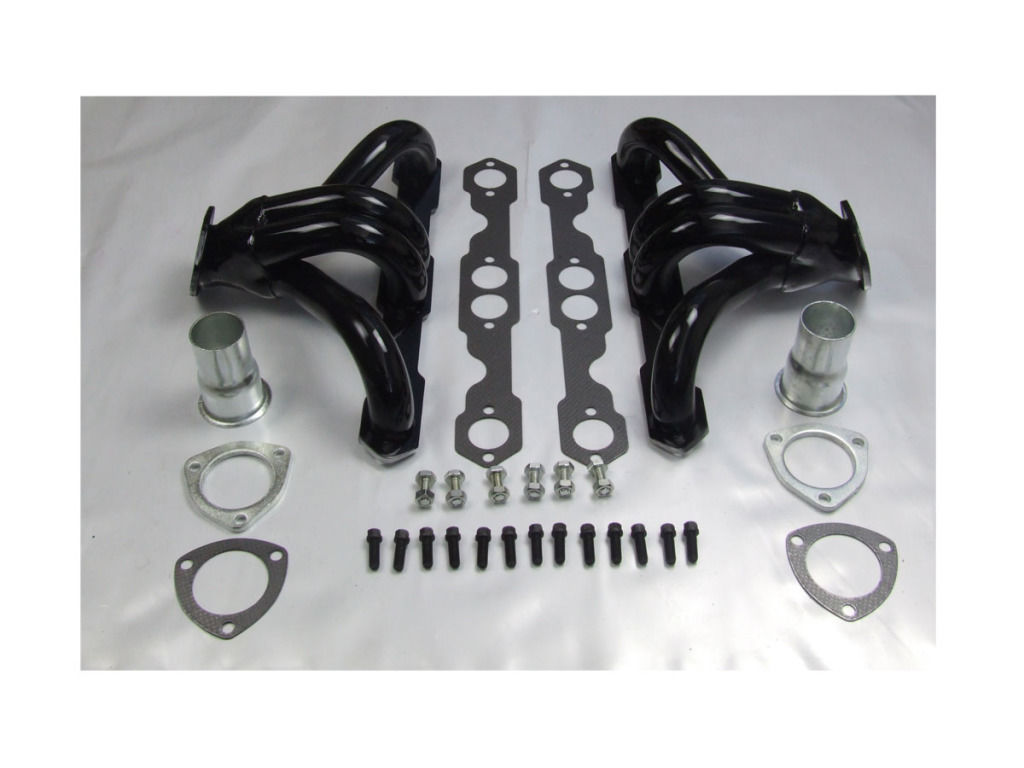

Block hugger headers like these will work?
75 Luv 350/TH350 (Project in progress)
PostPosted: Sun Mar 02, 2014 5:58 pm
Usually. I have had to make a pie cut on the outer side at the flange and roll the flange towards the fender some and weld it up due to the flange hitting the block and not letting the header flange seal up. Depends on the manufacturer I guess. Only a couple of times I have had that though, you probably will be good. Just something to be aware of...
PostPosted: Sat Apr 12, 2014 8:17 pm
If you can swing it now I would recommend installing the Hooker Headers now. I ran the block hungers and I also had to modify them to work. I also had a pretty sharp bend to clear the mounts. I then installed hooker headers and had to pretty much lift my engine up a few inches to install them. It would be much easier to install the hookers while installing the engine. Just my 2 cents and what I went through.
