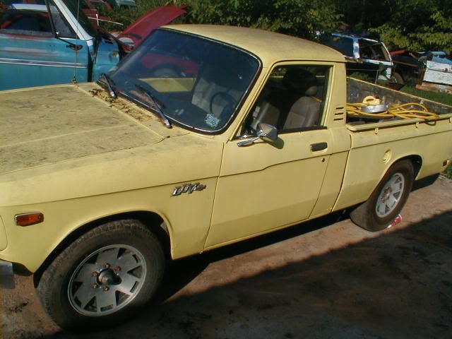

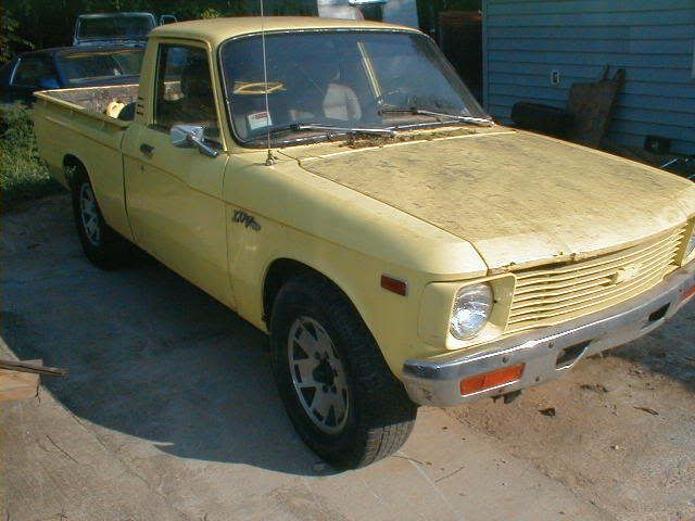

Look what I pulled out of the woods.
I got a nice deal with this one I must say, I pull the Oldsmobile v6 out of it and it is mine. Came with a bed full of junk and trash lol. I also found some new chrome headlight covers for it. As soon as the engine is out my 1st objective will be to kill the big bird yellow. Then I will be putting a 4.3 and 4L60E down in it. Then S10 swaps both front and rear.
Any paint suggestion's? I was thinking about painting it white since I have about a half of gallon left over from painting a 2002 Silverado however I may mix it up a bit white by it self may be just too boring.
PostPosted: Mon Aug 13, 2007 7:38 pm
Nice find! A/C (at least it used to and still could), bucket seats.
What are those wheels off of? I've never seen any like that before.
Looks like it was painted last in the 90's, when that euro, paint the whole vehicle all one color (grille, bumpers, door handles, wipers, and all trim) thing was going on. Kind of the beginning of the ricer thing today.
Enjoy the fun project.
The nice thing is, it's a complete truck to start with. It has all the door panels, window cranks, glass etc.. Dash looks pretty good too. Compared to some I've seen anyway.

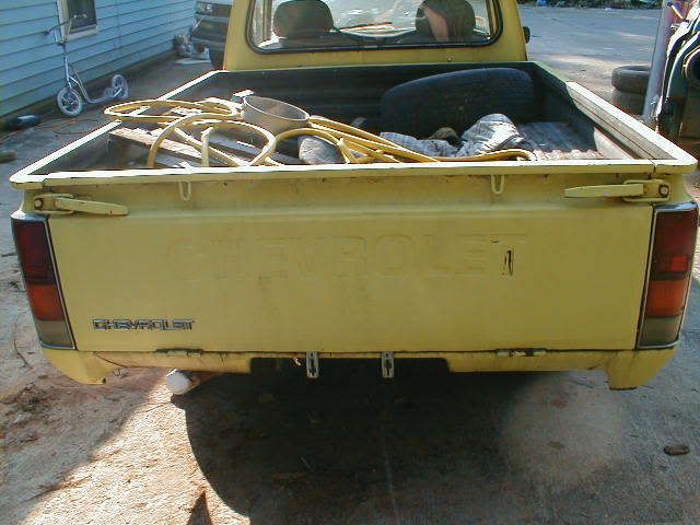

wat year is it? ive never seen the chevy embelem on the tailgait like that is that stock?

What are those rims off of? They look sort of Isuzu-ish but I can't put my finger on where I've seen them before...

It's not stock. Someone just stuck it on there.

It is a 78. The wheels are off a trooper and has a matching spare (Will either sell or scrap). The rear end is out of a trooper and looks a little narrower then I believe what my other trucks look. The emblem on the tailgate are off a Chevy aerostar van (Do you want it? lol). The seats are out of some sort of kia and are electric and work. The guy said the AC worked good. I don't understand the deal with the rug on the dash other then slightly rolling at the windshield it is nearly perfect. The trucks factory color was yellow and they just scuffed the factory paint and laid down some more big bird yellow. The guy painted the headlight covers yellow because the chrome was flaking off the plastic and painted the grill to match. The grill will be stripped and brought back to its black self and the rest of the truck is going white. I am thinking about two toning the truck just don't know what with. It will be anything but yellow.
The guy wanted $600 to start with. I talked him down to $450 for the truck w/o the engine or trans w/ him removing it. BUT then I talked him down to me hauling it and pulling the engine out, Then he will pick the engine up and I will get the truck for that labor.
I am planning on giving it a bath and pulling the engine out tomorrow if I have the time and I don't fry in the sun.
