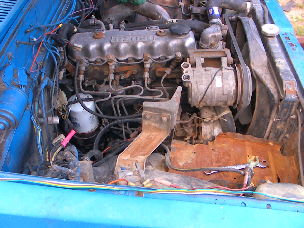

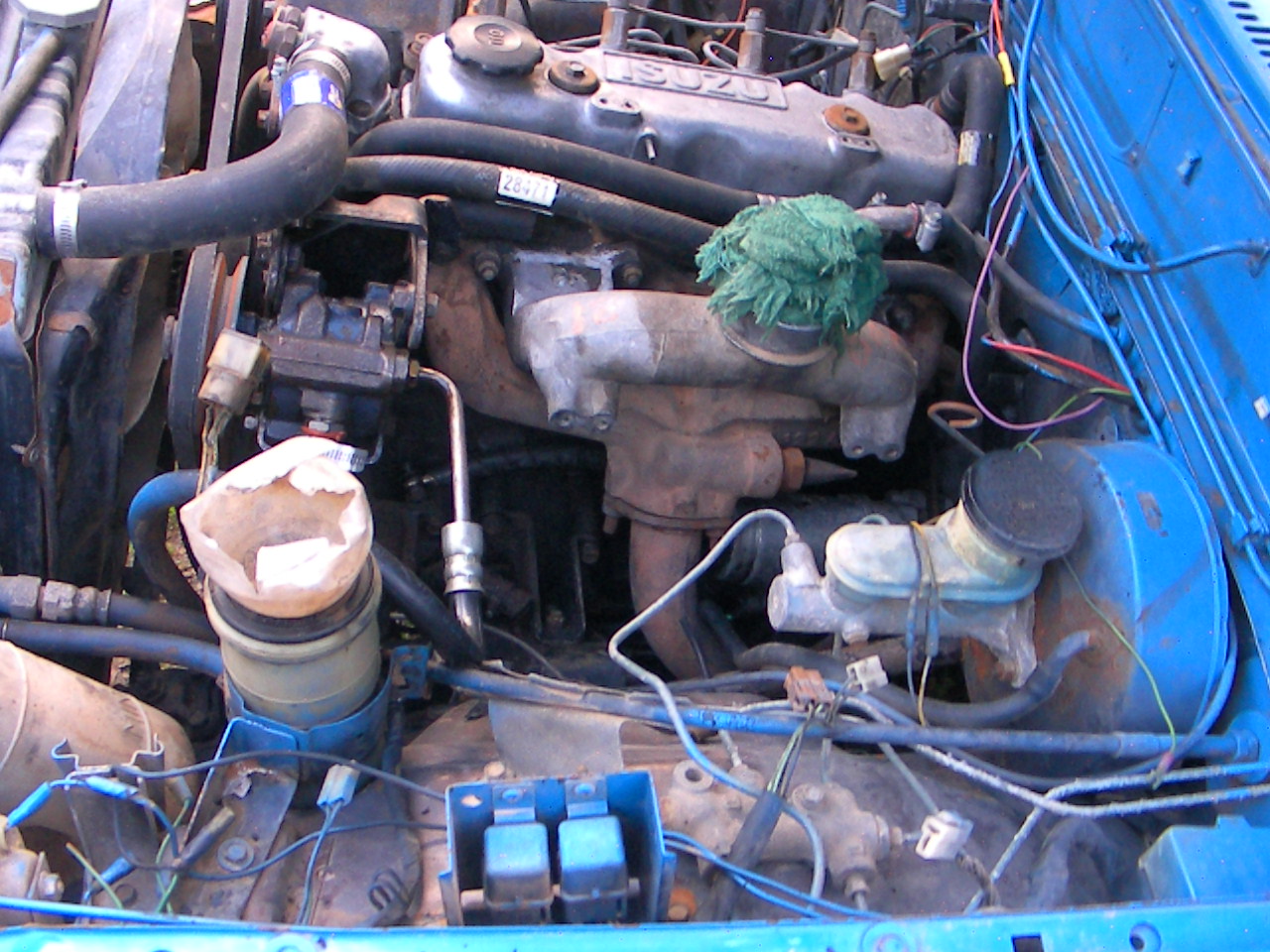

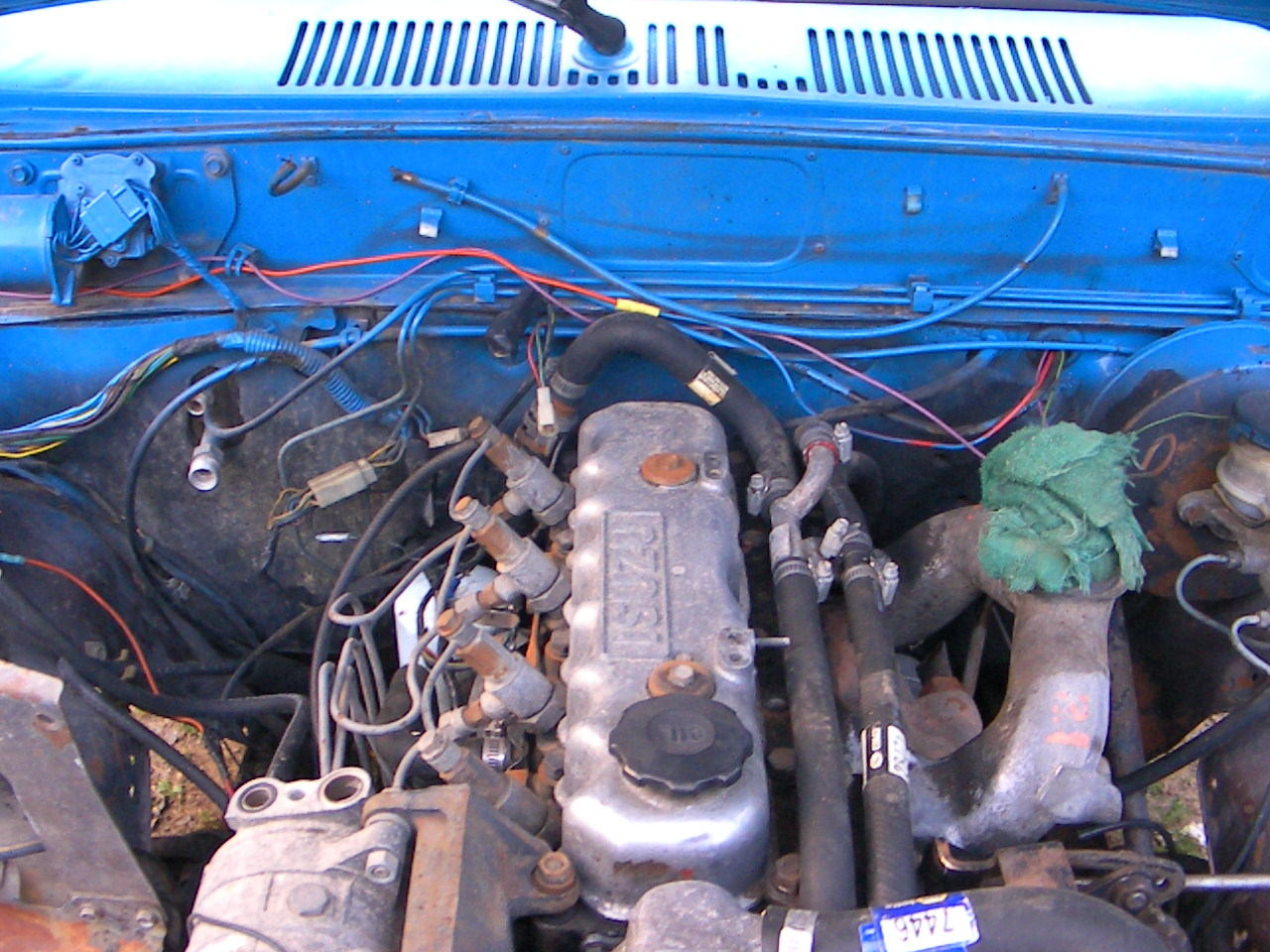

this is a 1984 isuzu pup that was origanaly a CA spec diesel pup with a EGR systom, :!: so the items may not be in the same places :!:
im gessing your starter relay is some where on the drivers side where the two are in the bottem pix, but those may be for the glow systom i just dont know.
or mabe my pup no longer has it, sence the wiring harness has been hacked up so bad.
the lower three pixs can be cliked on to make bigger, im limited to three of them per posting, so the top one is posted in a diffrent manner
(it can not be made bigger by cliking on it).

PostPosted: Sun Nov 01, 2009 10:17 pm
Joined: Sun Sep 14, 2008 4:19 pm
Posts: 9
thanks again trooper
the only thing i recognize are the two blue boxes located in the last picture. could these be relays. is there any way i can check them. you are very kind to put up with me. after seeing the pics of your love i feel guilty having such a nice pu. it just wont start. do i understand that you are going to diesel school. when i was young i sailed a 33ft out illand sail boat to south am. had a 2 cy volvo. when i got back to states i went to a diesel school in jacksonvile fla to get it overhauled. should have used it for an anchor. thankis again trooper. old timer
PostPosted: Mon Nov 02, 2009 12:36 am
Posts: 460
Location: MP 48~ on OR US 30
yes they can be tested but not with 110V, must be 12V or it will be junk from the 110V :!:
first remove the relay from the auto then
put 12V to the ports that send the power to it, that will engage the continuity though the relay on the other two ports.
then put a volt meter on the other two ports, on ohm mode, and see if it has continuity and low resestence with the volt meter.
if there no continuity or high resestence then its bad.............
