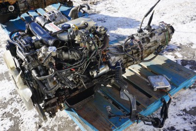

Hi all, I'm looking at swapping in a diesel engine and transmission into my '79 4x4. While the occasional c223t from an 86 trooper shows up on craigslist every once in a while, for just a bit more $ I could pick up a much less used, more efficient and more powerful 1KZ-T or 2L-T. The engines themselves are pretty small (and I have a ~2inch lift on the truck), it's the transmission fitting that I am worried about. The transfer cases for the front drive shaft for most models are on the right (and correct) side, but the shifters may not fit well in a cab with a bench seat.
Does anyone have experience with these? I'm not worried about the fabrication side of things, just the length and fitment issues I might be missing.
P.S. I've also been looking at Isuzu 4JG2-T, and 4JB1-T engines, but those are nearly impossible to find, or are connected up to an automatic transmission. A wild card option is Nissan's TD27 (though the front drive shaft may hook up on the wrong side for a 4x4 LUV).
Picture is of a 2L-TE (ecu model)

Thanks for the insight! That's pushing me toward a later model engine with ecu. I have a 2inch suspension lift - that said, I'm looking at coil-overs soon and could do a body lift to maintain clearance for my tires and taller engine, and then reduce the lift through the suspension.
I've asked a seller about dimensions, and will look around for measurements to mock something up. These engines/trans came out of right hand drive vehicles, so a clutch setup is still a bit of a mystery.

Just put in an order for a 1KZ-TE, fingers crossed.
Quote:
A 4bt may fit but they are just so flipping heavy! And they're pretty tall.
Second that on the 4bt, they weigh something like ~750lbs, and are 37" tall.
There's not a lot, any actually, information on the engine dimensions of the 1KZ. It's cousin, the 1KD is 30" from top of the turbo duct to the bottom of the oil pan. So who knows what kind of magic spells I'll need to cast with my Millermatic magic wand to make it fit. May need that body lift after all.
2L vs 1KZ. If anyone else is going to do this, there's no reason not to choose the 2L. As Jack was saying, the older motors had some head cracking issues. And while the newer motors may also have a weakness in this area, well, LUV owners already have a lot of experience rolling the dice on head related issues. AND - there are aftermarket heads that are better designed if a head were to crack.
4x4 Transmission - both the 2L and 1KZ are regularly mated with a R151 transmission, with the shift lever located 19" from the front of the bellhousing. That's pretty close to a stock 4spd in my 79 4x4 - I'll post magic wand pictures as I modify the transmission tunnel.
The hardest part of this swap is probably going to be getting the ecu and gauges hooked up.
