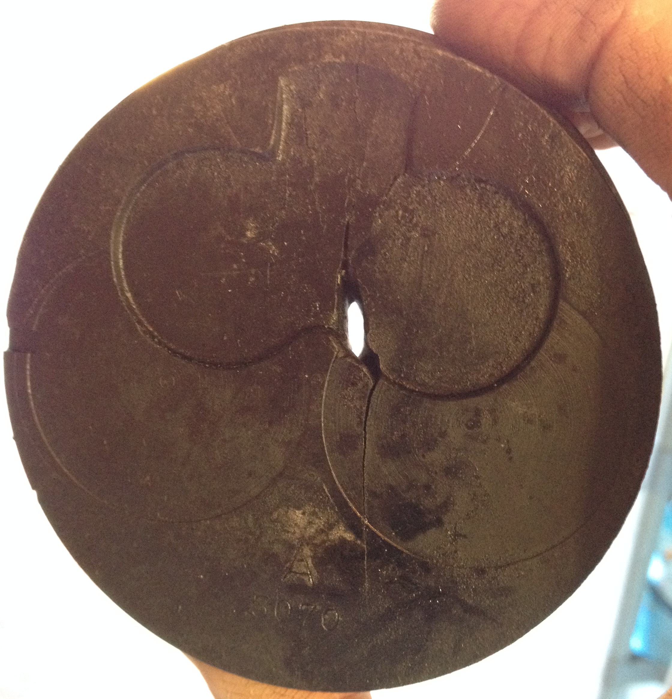

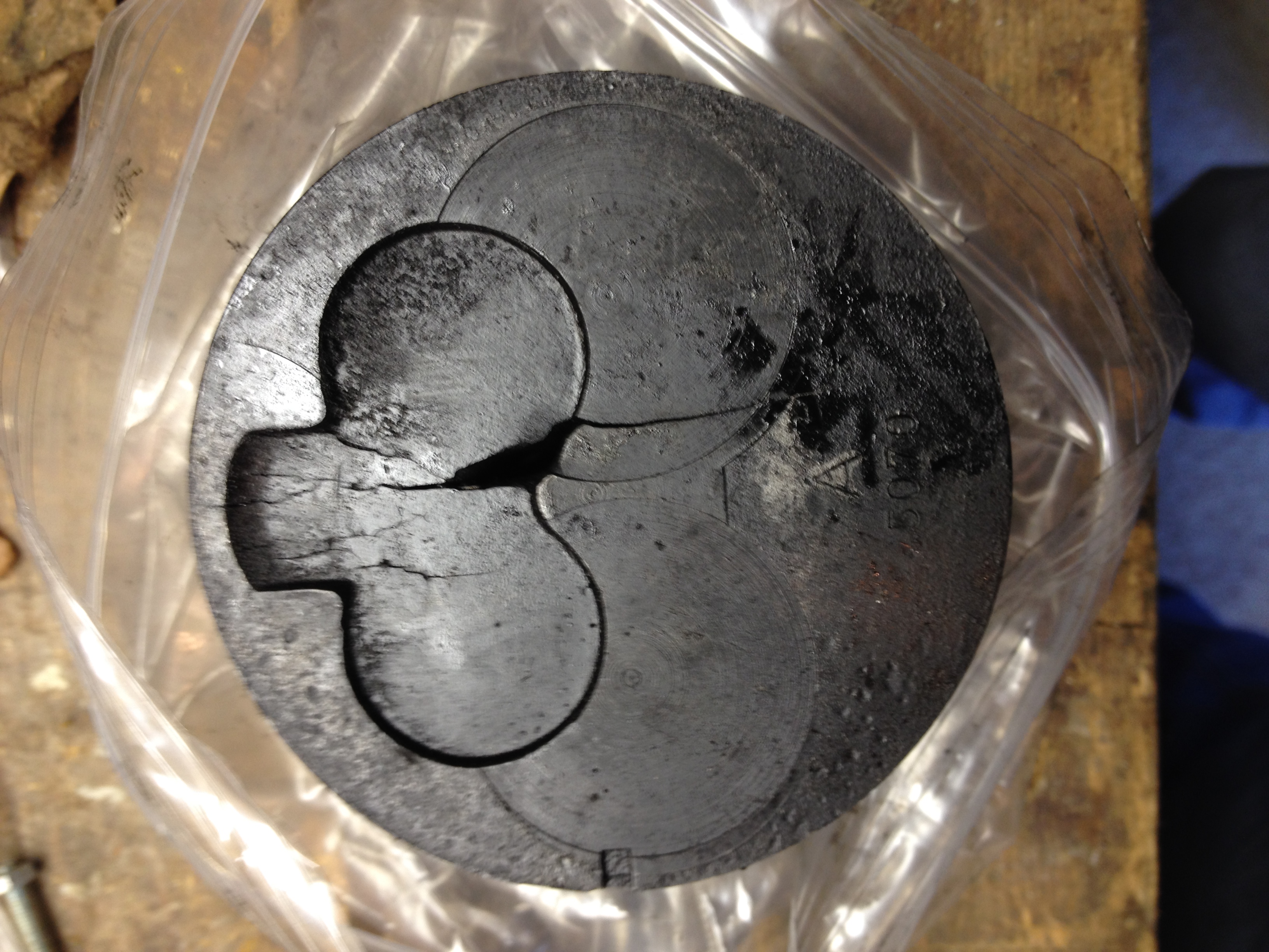

Take a look at what he found when he got the pistons out!
File comment: This is the top of a piston!

File comment: Here's another shot of the same piston, with the light from behind!
I can't figure out why it ran so well. I drove it around 75-85 mph on the highway between Memphis and Atlanta, with no issues. I had a spare gallon of oil, but it was still at the "full" mark after I arrived.

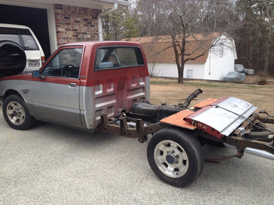

Anyway, the truck finally came home a couple of months ago. I sold the bed while it was in Atlanta, because I found a better one in my local Pull-A-Part. So I drove it home without a bed.
Next is body work and paint.
File comment: Here it is, ready for the trip home.

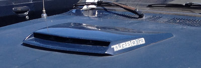

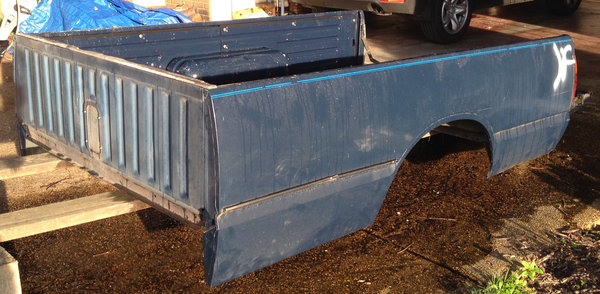

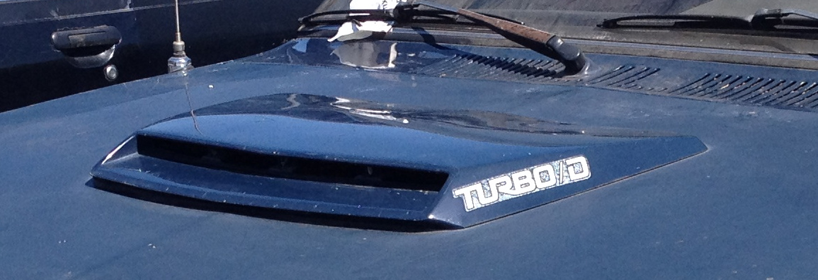

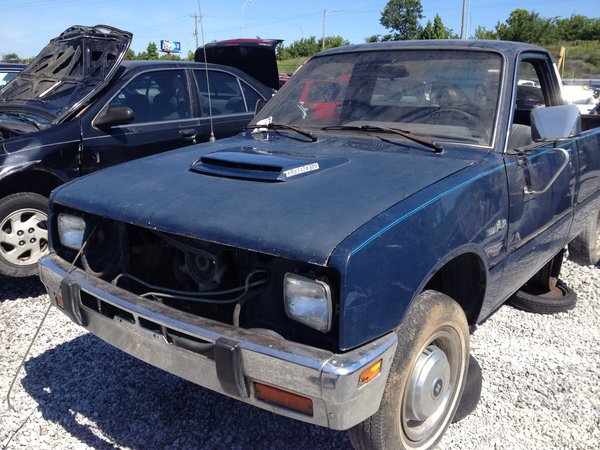

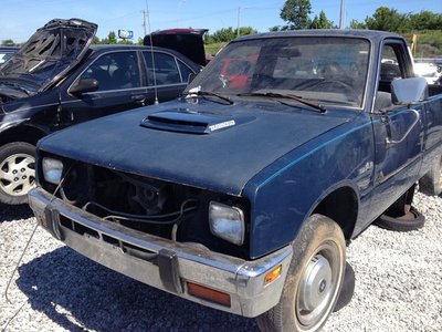

Here are some shots of the '86 I pillaged. I had a friend who needed a transmission, so he got that, the driveshaft, the instrument cluster, maybe the dash, and some other stuff. I got the engine, hood, and bed.

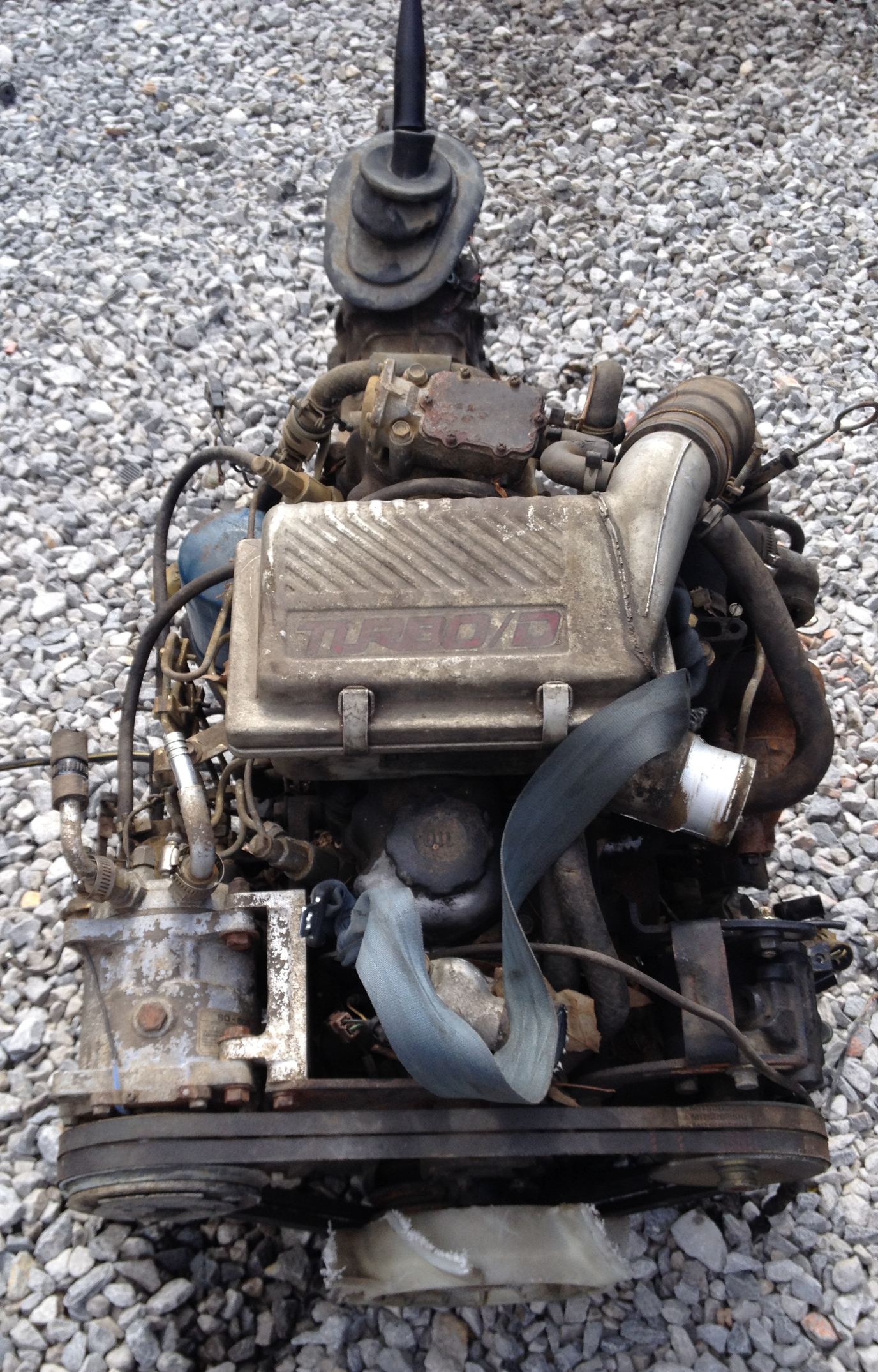

And the engine/transmission...
