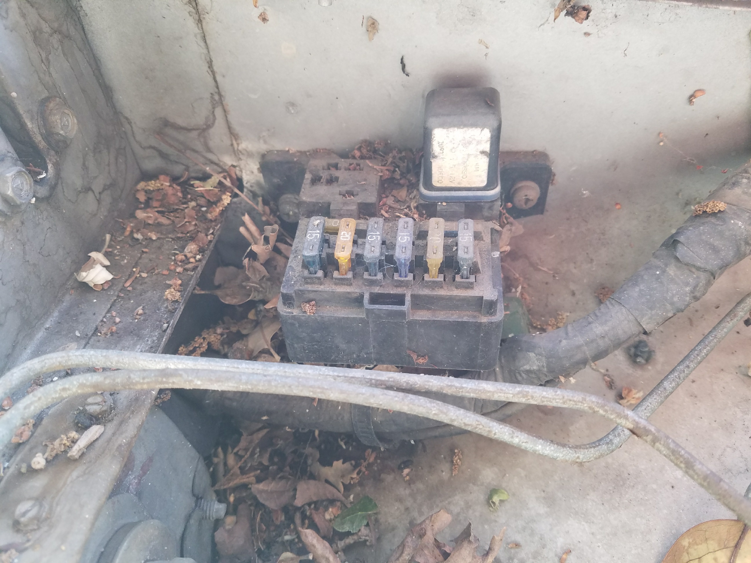

Hey guys! im trying to replace the relay in the fuse panel but I cant find a part number to save my life! anyone know what the part number for this relay is?

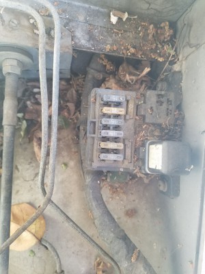

another angle.
