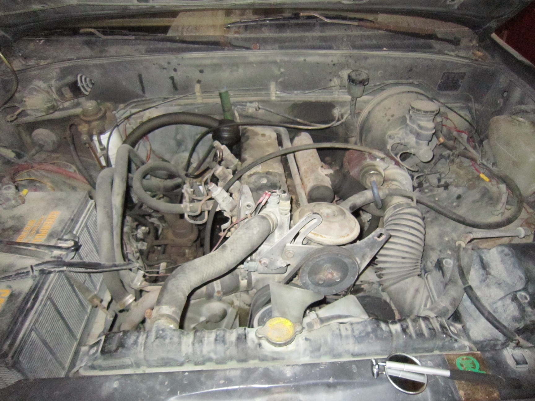

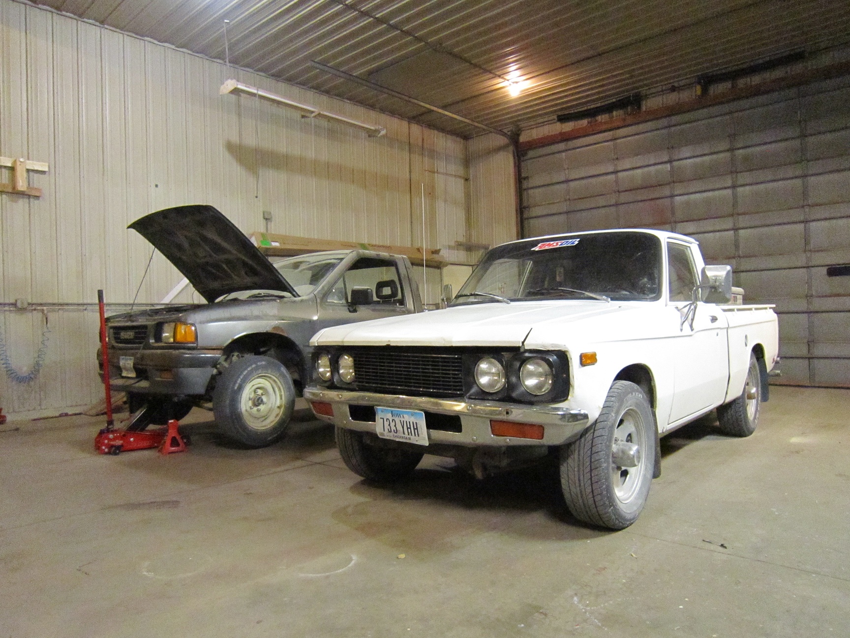

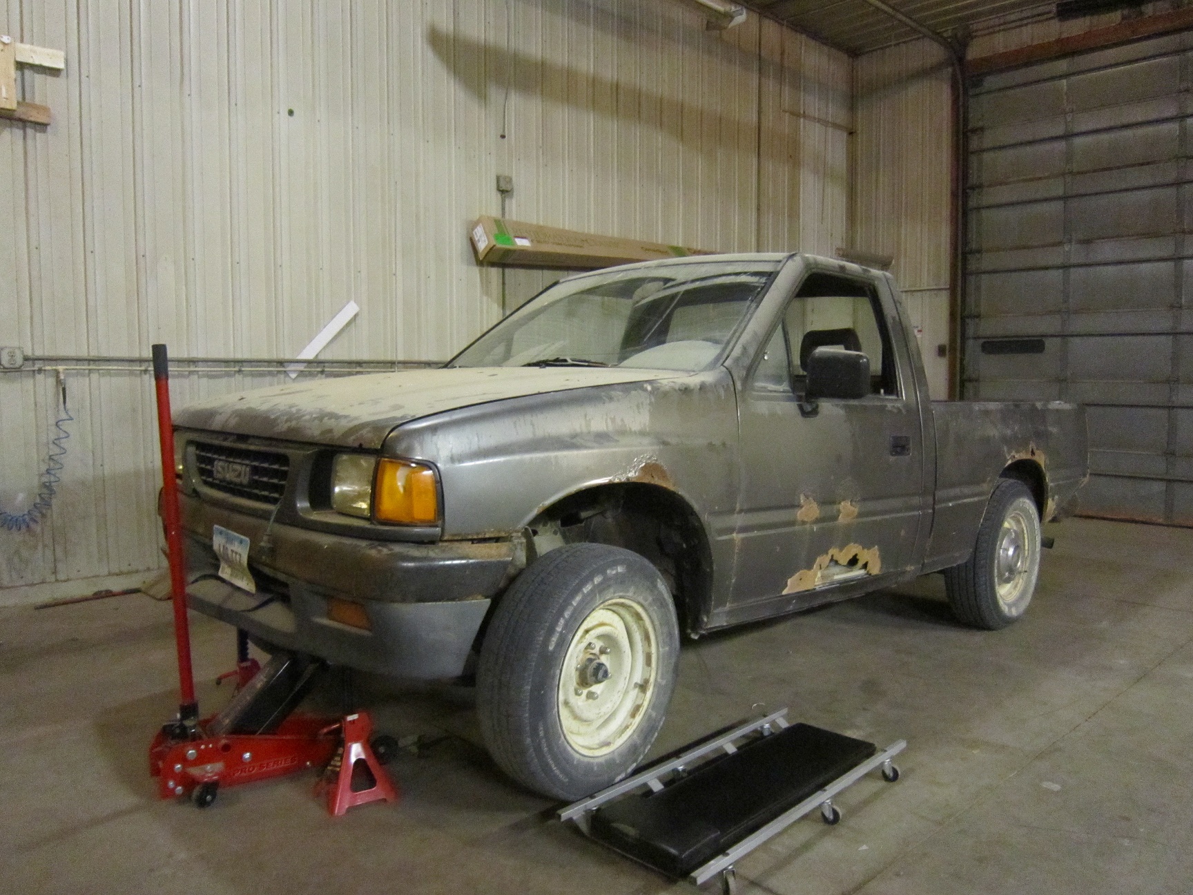

I finally figured out the pics were to big, so i resized them and it worked. So take a look at them and tell me what you think.
Thanks, Brendon
PostPosted: Tue Dec 03, 2013 6:58 am
Joined: Sat Aug 10, 2013 12:24 pm
Posts: 65
Location: New Hampton Ia

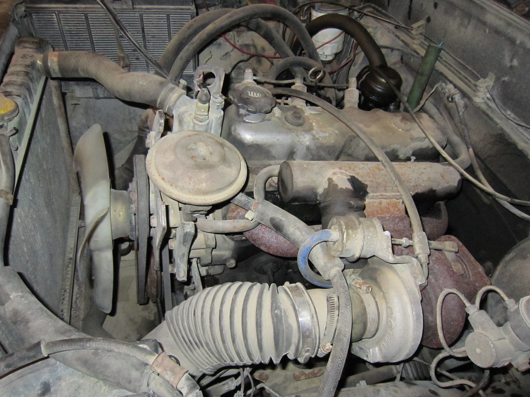

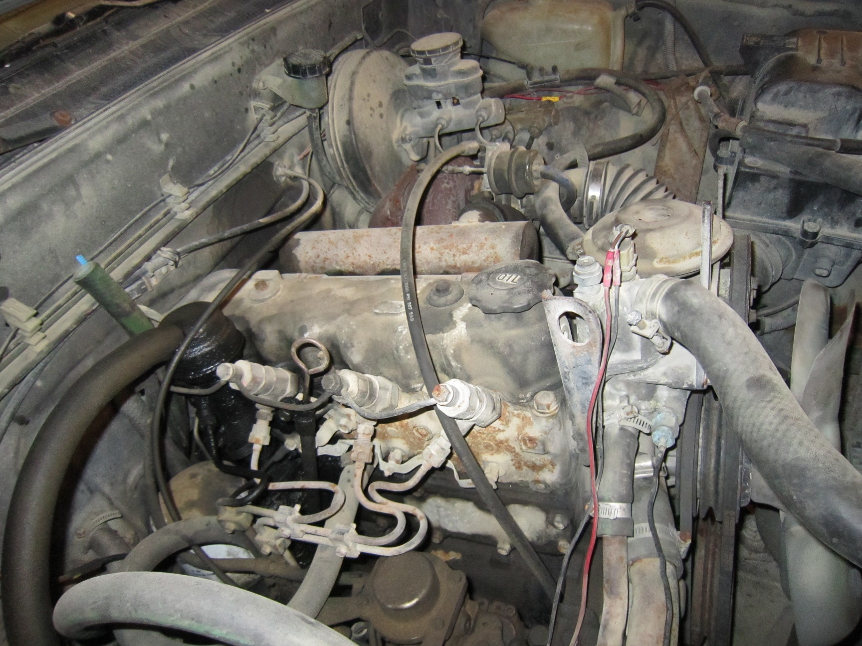

Got a few more pics.
PostPosted: Tue Dec 03, 2013 7:44 am
Posts: 1703
Yes, it's definitely the GM version of the engine, and it's pre-'84. You may have a tough time finding a water pump for it, because it's not the same water pump that the Isuzu version uses. GM used their own water pump and thermostat housing so that they could use the same radiator as their gas-powered S10.
The transmission is also GM (Borg Warner) as you said. And the vacuum pump is right out there for easy access. The turbo setup is all aftermarket.
