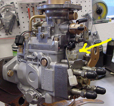

BeastlyLUV 82 wrote:
It makes sense, where is it at?
It's on the injection pump, with electrical wires connected. Here's a photo of the pump. Keep in mind, you won't see it from this side, because this side is against the block. But it clearly shows the fuel cutoff solenoid in the rear of the pump, just above where the four fuel lines connect.
What do i do with it?
Is that the part that "broke off in the hole"? You mentioned a relay, but there's no relay in a hole anywhere. I thought it might be the cutoff solenoid that you were having trouble with.
