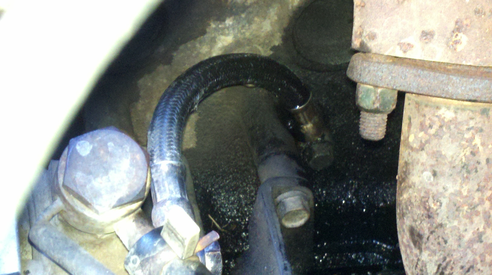

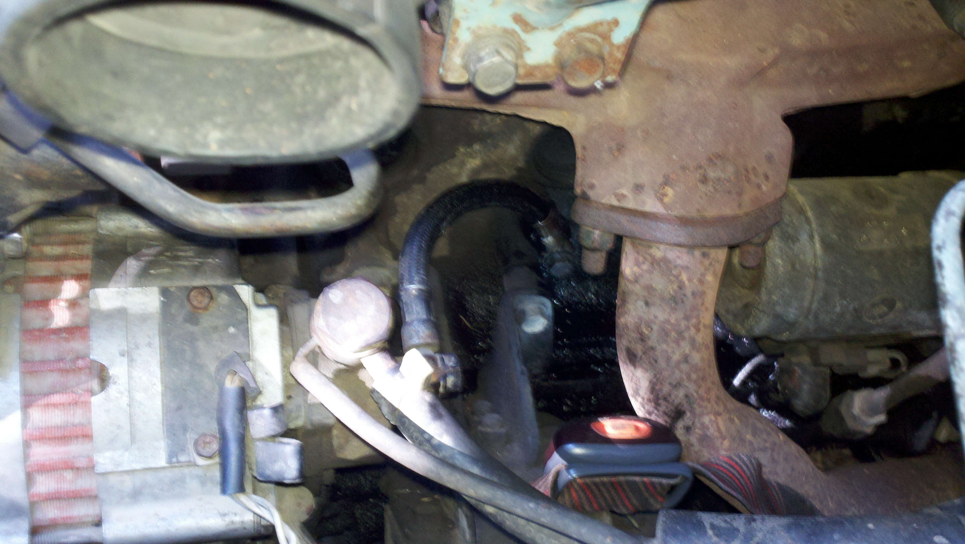

Anyone know what the name of this part is? It's the flexible pipe/hose that comes off the back of the ?vacuum pump? that is on the back of the alternator. It connects into the block. It sprung a leak on me and now i'm leaking oil everywhere. I drove around with it for at least a day, until a buddy called me up and told me I leaked oil all over his driveway.
For bonus points, Any Ideas where I could get a new one? Or a part number? Or somesort of compatible part that is still available. It looks pretty specific, not like anything they had at the local parts store. I've got a guy at the parts store doing the run around, trying to find one for me. The only info i could give him was the GM part # that i found in the Master Parts list, which in 94028195 and that they call it a pipe.( Well, I'm assuming thats a GM part number. I guess it could be isuzu...)
Thanks in Advance!!!!!
ooooohhhhh...and incase my signature doesn't say, I drive an 82 short bed chevy luv diesel, series 12 w/ C223 2.2L, a lovely faded metalic blue color.
File comment: the flexible pipe comes off the back of the ?vacuum pump? on the back of the alternator and goes into the block.
File comment: Name this Part! It started leaking oil on me and I tried to describe it to the local autoparts guys and their eyes glazed over just listening to me.

Adam, it's the oil line for the vacuum pump. It's a wonder you didn't ruin your engine. Those things will dump all the oil in a big hurry. I'll be your tailgate has oil spatters all over it.
I'm sending you a PM with the contact info for a guy who keeps a bundle of those genuine Isuzu oil lines in stock.
I'd like my bonus points, please! ;)

It is a wonder that I managed to get away without any serious damage...so far as I can tell. It's got oil all down the bottom side of the truck and all over the tailgate. What a mess! Luckily Jerry had the parts and my LUV is up and running again. As for your bonus points, I've already deposited them in your account on the Karmic exchange. :wink: Good luck is coming your way...so watch out! :ebiggrin :ebiggrin
