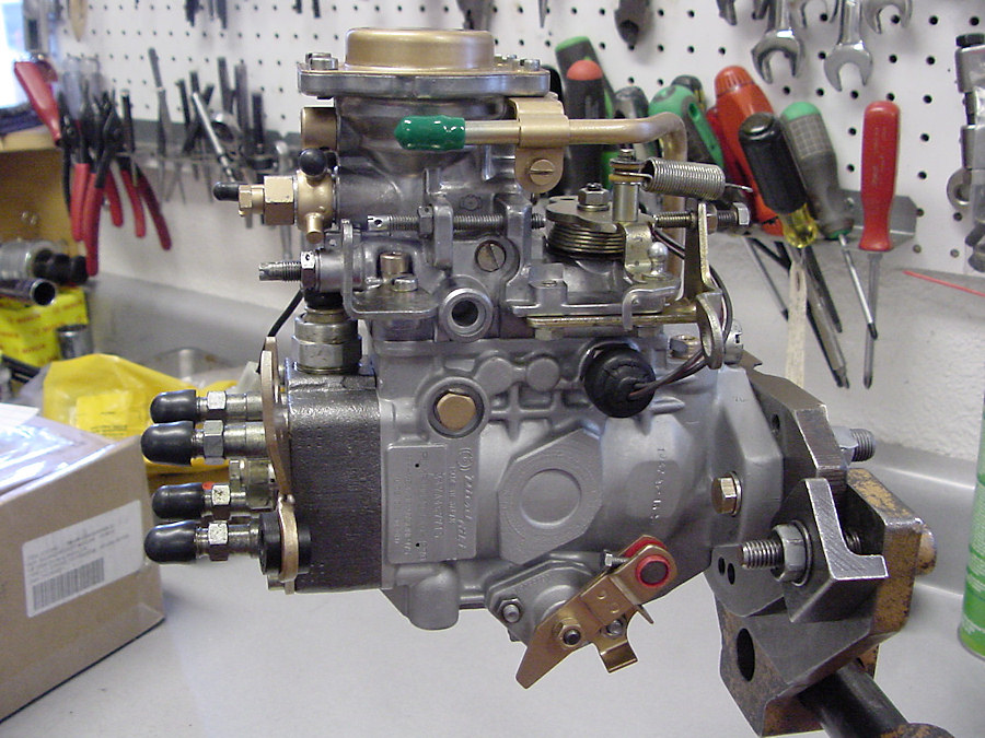

New to me Luv Diesel. I need to reseal the IP or have my IP rebuilt. I'm having trouble finding a source for parts and a rebuilder for the IP. :econfused I've tried several searches here, but I must not be going about it properly. Info / help on IP rebuilding appreciated.

Some of the seals can be replaced at home. The CSD seals, and the throttle seal, for example. The head seal requires a special wrench, but if you could get the wrench you could replace that one. However, after 30 years, it could probably use more than just new seals.
I recommend a complete rebuild. It really can't be done without special tools and test equipment. When I had mine done a few months ago, they found that the input shaft had worn down and was just out of tolerance. They had a new bushing machined to fit, and they did a fantastic job. The shop offers a $50 discount to IsuzuPup.com members, and they had pretty fast turnaround. The work was actually done by one of our members who works at the shop part-time, and arranged for the discount.
Here's the "after" shot of my pump before they returned it to me. Note they replaced the Cold Start Device with a VW manual one, because the Isuzu CSD was really troublesome. That's a $100 "extra" they offer.

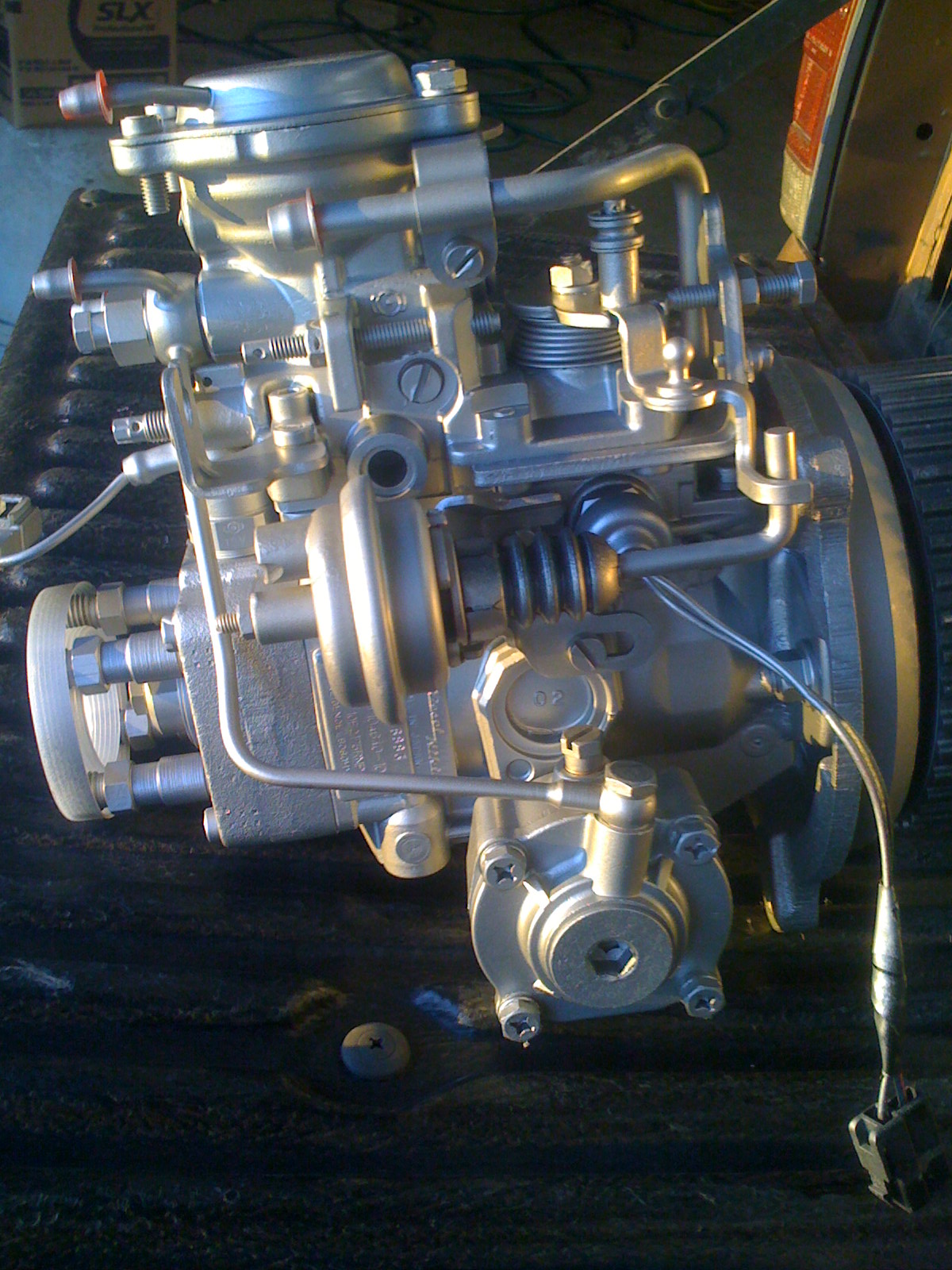

i had my pump rebuilt at arkansas fuel injection. cost $368.00 phone # 501 -565 -3712. they did a great job

I've Used AR Fuel Injection for rebuilding my Injection pump and also my injectors. Nice helpful folks . They re-did my injectors while I watched and waited.
They also recommended using Stanadyne Performance Formula Junior Additive to prolong IP life. 2oz to 15 gallon.

That pump is for a turbodiesel and has a tach sender. Wow!
Good price, too.

Can someone tell me what the orifice is in the bottom right of IP photo IMG 0492.JPG? It has the plate held on by four screws, a metal fuel line going into the top and what looks like a set screw between the fuel line and the IP main body. My pump is leaking badly (full tank lasts 1 week instead of 3) and I think its the gasket under the plate

Cold Start Device ("CSD"). I've never heard of one leaking THAT badly. I apologize in advance for redirecting traffic to my site, but someone just posted a very detailed topic that is EXACTLY what you need.

Glen, the CSD is supposed to help with cold starts, so disabling it would not help. However, mine has been disabled for a few years now. I've had no trouble starting, even down to the 20's. If you're having trouble with it below 38°, maybe something else isn't quite right. You can test this by temporarily disabling it. Remove the spring (as outlined in the topic that I linked to), and replace the banjo bolt on top of the CSD with a solid one that will fit tightly.
