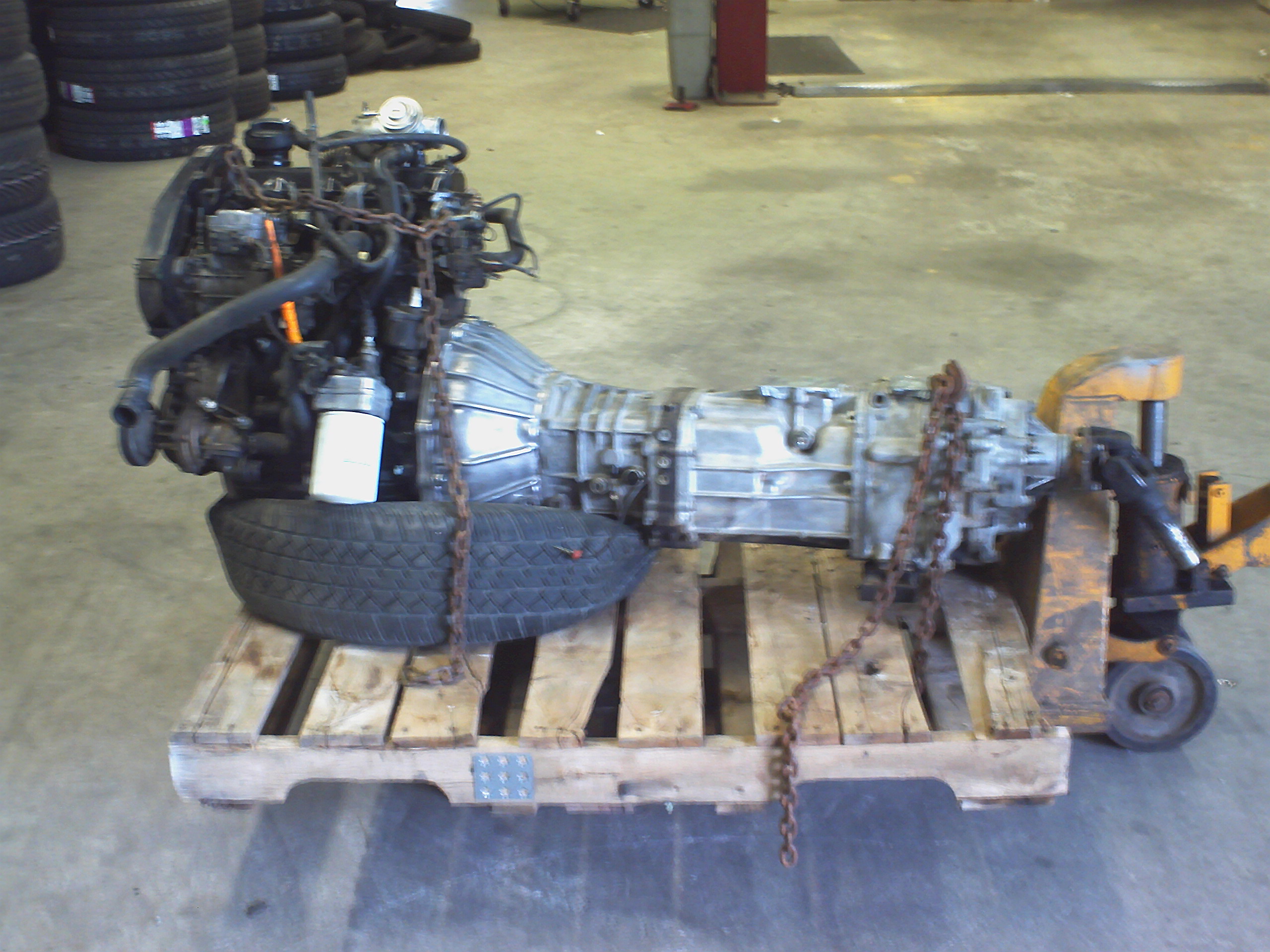

i'm attempting that project on my 81 right now. It is a hard project for me, considering i have very little experience in engine swaps. But i'm almost done. That same episode is what got me going. The main problems i have run into is mounting, and the cooling system. The later tdi engine has a oil cooler that complicates both problems, as well as the toyota trans length. Over all it was a fun project. If you have any questions, ask me.

I got my tdi for $1600 at a junkyard half a state away. they are hard to come by, but so are the other engines. If you go tdi you'll either need all electronics or a m-tdi injection pump that is also costly, around $1200. I know three places to get one, I guy in canada makes them but you need to find all parts yourself, another one who has been back ordered and is not out of parts, and the guy i got mine. i still has his email if anyone needs it. Below is a picture of the new pump, the who drive train and me with the enigne. Im not a wizz in automotive and i might still be an upcoming senior in high school but this project is helping me graduate, i have learned a whole lot out of this.

The pump guy in canada i knew of was Giles. Alot of the VW pump forums i looked at refered to him several times, but i didn't know enough about the pumps to send the right parts. I was able to work around the stock oil cooler, but i might look into the remote filter if i decide i want to do some harder off roading, it hangs down just enough to worry about it. My original plan was to use the computer and harness, but the junkyard already sold the ecu and there was just to much wiring to have to go through. thats why i went M-TDI. I think my pump will do just fine, cause i have seen people that took an old pump and put a 10mm cam plate and new plunger on it and every thing ran fine. I'll have some more pictures later on after i figure out what is wrong with my camera.
