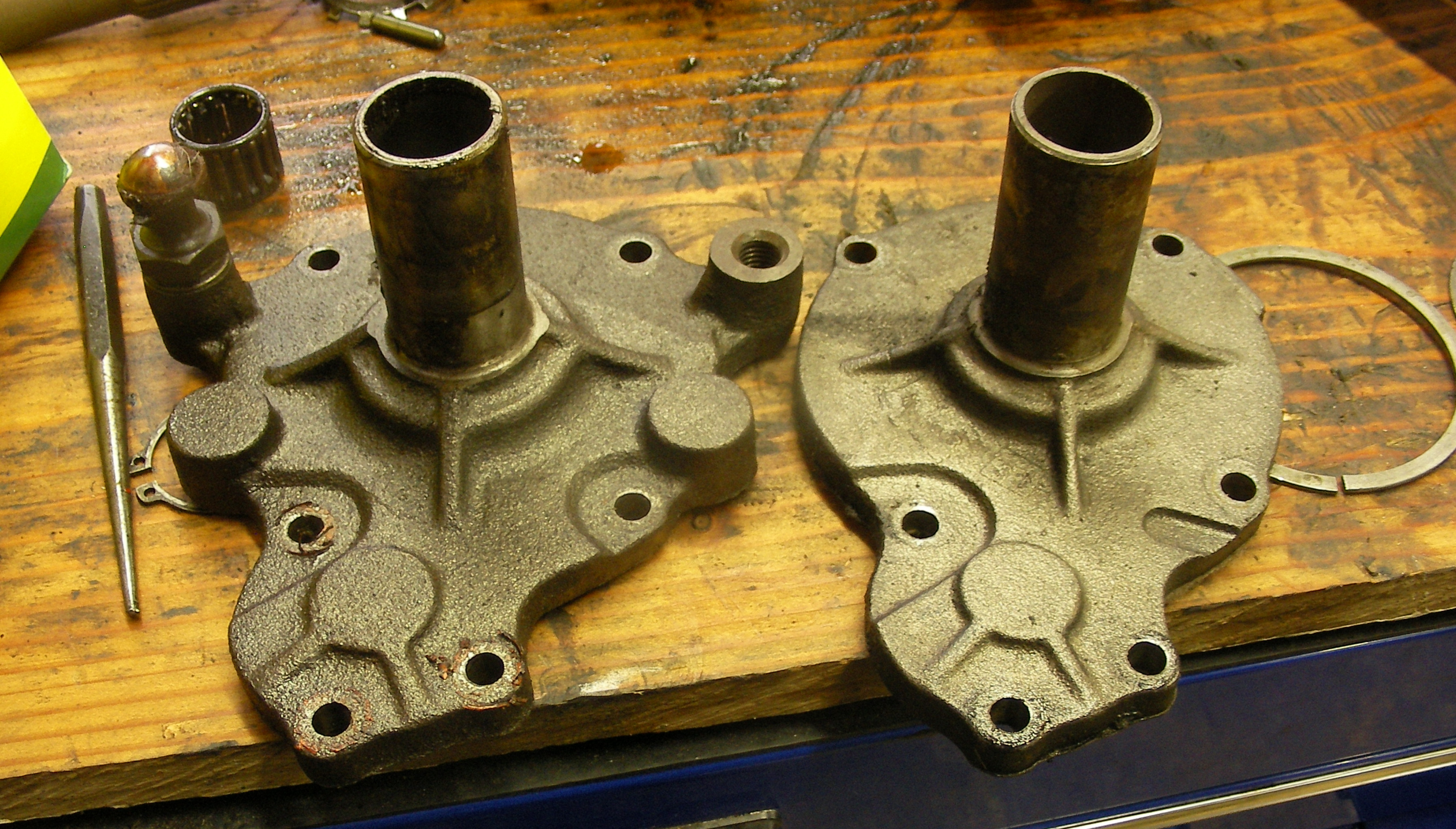

Wait, you said you had the cover off. Can you post a picture of the main bearing cover plate that was on the salvaged transmission?
Better yet, see the photo below. I'll bet yours looks like the one on the right. If so, maybe we can find you one like the left one.
PostPosted: Wed Jan 06, 2016 12:38 pm
Joined: Thu Nov 19, 2015 8:03 pm
Posts: 61
I just woke up and have not taken pictures yet but now I don't have to... That's the one I have. The one on the right.
Until I looked at some pictures I thought I had the wrong bell housing . What does this mean? Why would the tranny I got from the yard have one that screws in to the bell housing ?
Really does not matter. The question is where do I find a cover plate ? Do you think the same people who provided me with the bell housing would have a cover plate?

The transmission you pulled--did it have a pivot ball? Did it have a clutch cable? Being an '86, it should have had both--unless it was a California truck.
Yes, Dart & Deb probably have cover plates. You will need to make sure you get one with the same number of bolt holes as your bell housing has. Most had 6, but some had 4.
