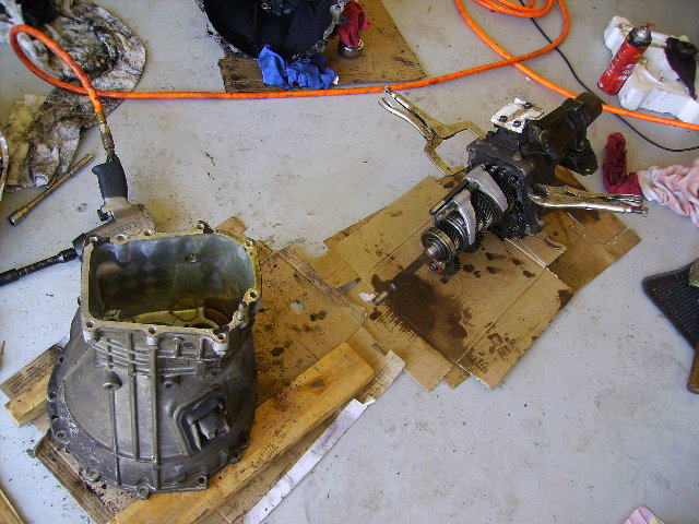

Here are photos that will show you the part that has to be swapped.
First, here's a 4wd transmission in the process of having the bell housing (front case) removed. Never mind that it's 4wd, the bell housing is the same. You can see that it comes apart at the center plate. The front and rear housings are aluminum, but the center plate is heavy machined steel.

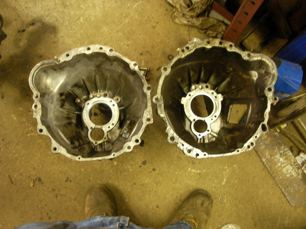

Next, a comparison of the gas bell housing vs. diesel. They'rethe same, except for starter location.

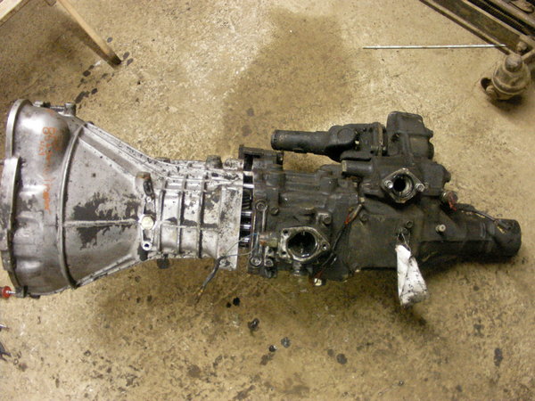

And finally, here's a gas transmission that's in the process of being changed over to diesel. In this photo, the gas bell housing has been removed, so that the diesel bell housing can be installed.
Hope that helps.
