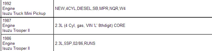

Here is what I found but I really just want something that will bolt into my 1979 4x4 Chevy Luv.

The 1992 that shows a diesel--there's no telling what that engine is, because it's not original. Isuzu stopped selling diesel pickups in 1987.

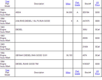

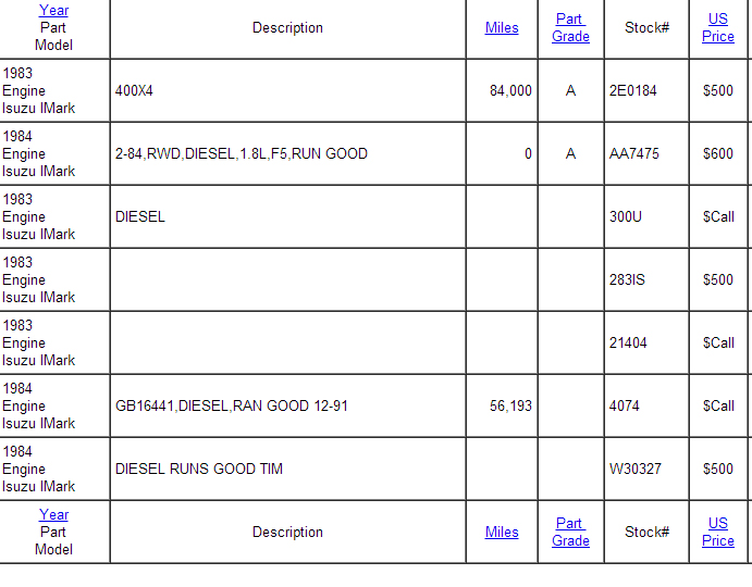

Here are some I-marks for sale will they bolt into my gas 4speed? Will I loose my 4-wheel drive?
PostPosted: Thu Jan 09, 2014 4:37 pm
Posts: 1703
The only reason you'd lose 4wd is by changing out the transmission. This motor should bolt up to your transmission, but I think you'd have oil pan clearance problems. Is your 4x4 a factory setup?
