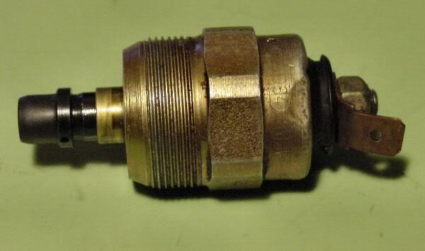

Here is a photo of the solenoid for those who haven't seen one:
