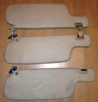

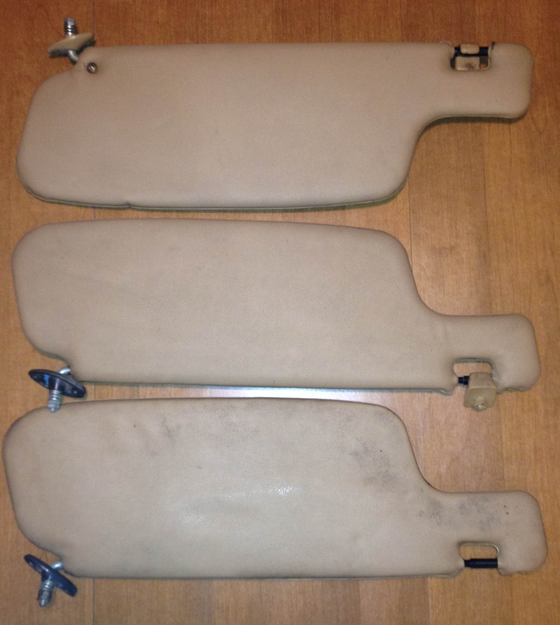

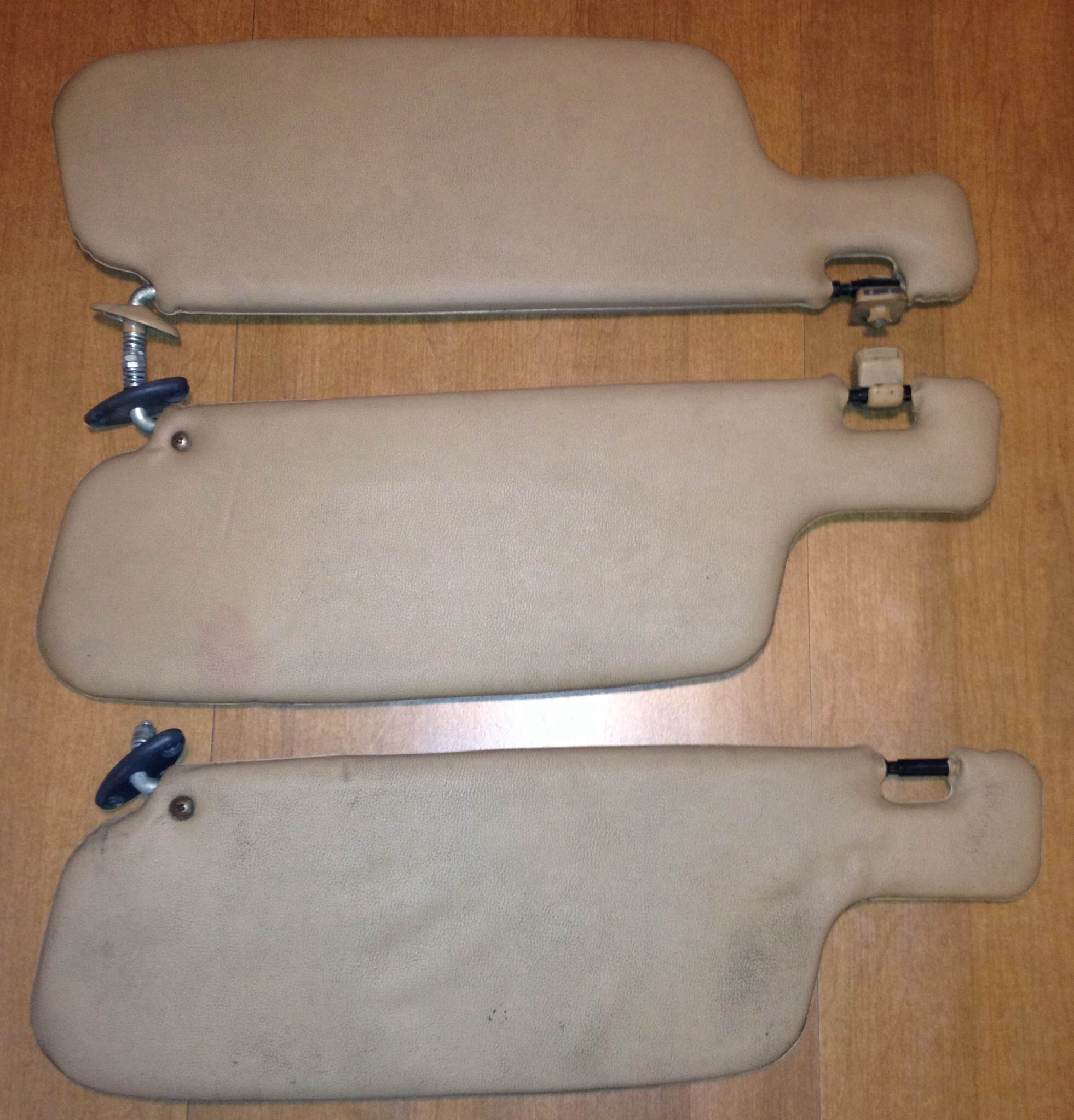

The top two are the cleanest. Just in case you weren't aware, the left and right visors are identical and interchangeable.
