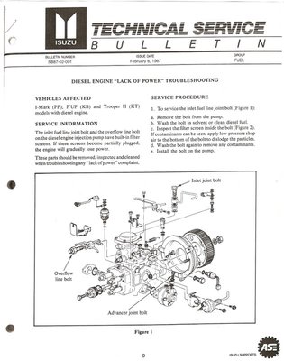

It does indeed sound like you have more than an air leak going on. My approach would be to first get it running on "the bottle", then once it's verified that it WILL run, start re-attaching fuel lines.
Yes, there are two screens that can prevent fuel flow, but it seems this would show itself as low power and would not affect its ability to idle and to simply run. But here's the TSB that describes it.

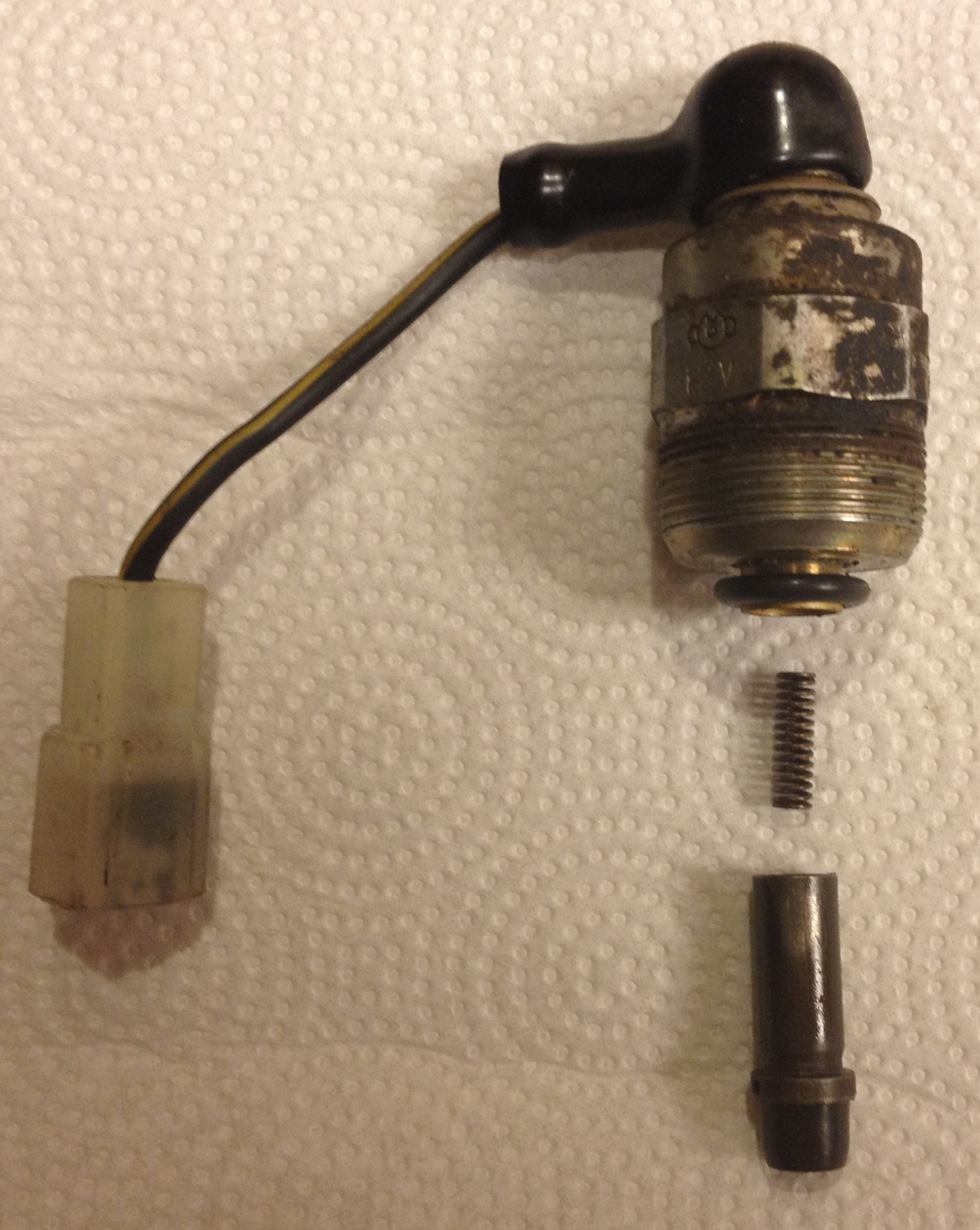

The pump has a cutoff solenoid.
INeedLUV wrote:
So Both the feed line and the return line go to the jug. I then try to use the bulb to push fuel through the injection pump and out the return line. First I try this with the bleeder bolt(that screws into a lager bolt) unscrewed a little. Fuel comes out the bleeder bolt, but it feels like it takes quite a bit of pressure with the bulb. The fuel in the return line did not move. Then I tighten the bleeder bolt down. Then I try to prime the lines more and push some fuel through the injection pump. I squeeze the bulb while watching the return line, but the fuel in the return line never moves. At the bulb, tt also feels and looks as though though no fuel is moving into the injection pump. The bulb is quite hard to squeeze, so it seemed like the lines were pressurized. So I don't really get why the fuel didn't come out the return line. Is there a screen between where the fuel can go out the bleed screw and out the return line? Is there some other problem that would prevent the fuel from passing through the injection pump.
There is a fuel cutoff solenoid that can go bad, but it's not likely.
However, if the key was in the "off" or "acc" position when you used the bulb, it's normal to fell this resistance because the cutoff solenoid is "cut off". That would be my next thing to check. The cutoff solenoid should be the only thing on your pump with a wire attached. To bypass it, remove it from the pump and then remove the plunger and spring. CAUTION: the plunger and spring tend to remove themselves, so don't lose them! Re-install the solenoid without them. Just be aware that if it starts, you will need another way to shut it off because the key won't turn it off.
Test it with the solenoid gutted, and let us know what you find.

I haven't removed and gutted the solenoid yet. Thats next on my list. But I've got a question first.
As before, I've got a jug of clean fuel with clear fuel lines going to the bulb primer pump then to the injection pump. Then a clear return line going back into the jug. I turned the key to "on" and tried to push fuel through the injection pump with the primer bulb, but was unable to. No fuel came out the return. No fuel went into the IP. The bulb is really hard to squeeze.
From what I understand, I thought that with the key in the "on" position that I should be able to pump fuel through the IP and out the return line. I really don't understand what would prevent this from happening. I thought for a second that maybe the solenoid wasn't getting power and thus wasn't opening. So I removed the wire, turned the key to "on" and put the wire on the solenoid and I could see a spark and hear it click like it was working. So it seems like the solenoid is working. I just dont get why I can't push fuel through the IP. Any ideas?
I'll get back to you about what happens with the gutted solenoid.

Adam, it sounds like your solenoid is working, so I doubt you're going to learn anything new by gutting it.

I removed and inspected the fuel cutoff solenoid. It beautifully shinny and works great. o-ring is in good shape. Tested it out with another battery and it opens and closes fine.
