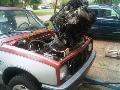

Did the rear main seal fit flush with the block? They are easy to damage because the later version of the seal is thicker. They come with a spacer. If the seal is thicker than the original, you're supposed to use the spacer.
I think the rear seal can be replaced without removing the engine, if you have room to get underneath it. Mine was a bear to get back in with the transmission attached.
