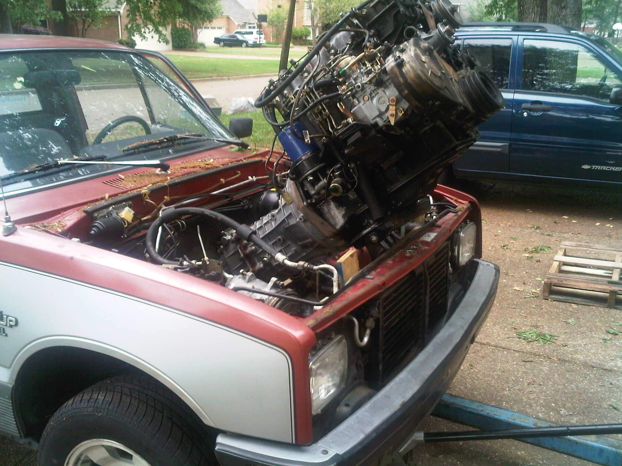

Did the rear main seal fit flush with the block? They are easy to damage because the later version of the seal is thicker. They come with a spacer. If the seal is thicker than the original, you're supposed to use the spacer.
I think the rear seal can be replaced without removing the engine, if you have room to get underneath it. Mine was a bear to get back in with the transmission attached.
The seal was really loose, my seal didn't come with a spacer is that going to be a problem? I could've just gotten to the rear main just by dropping the tranny but the truck is so low to the ground its hard to get under it, and its even on jack stands. The tranny's not attached to the engine though, so hopefully it won't be too bad. I'm waiting on an oil pan gasket before i can get it put back in. I'm just hoping i can get this all put back together again!
