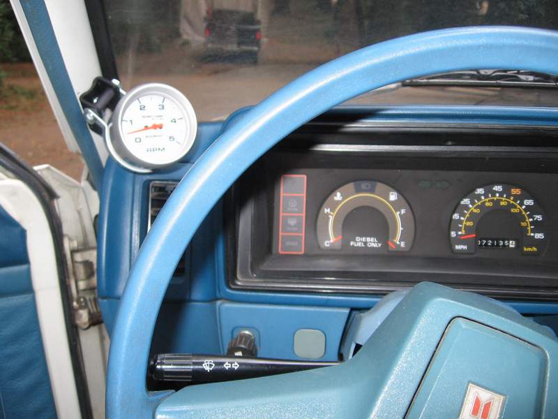

AutoMeter makes one for small diesel's; 5k rpm; sensor gets signal from the altenator. That is....sensor straps around the altenator with supplied stainless steel hose clamp.

CabezonBD, thanks and I really like where yours is mounted. Would you have a model #?

Here is the info below. Autometer also has the installation instructions for download on its site if you want to see whats involved. I shopped and this was the bestprice I found on line at the time.
BTW, Where I istalled it, the ring of the mount needs to be "bent/twisted" so it's more in line with a better view to the drivers view. If this doesnt make sense, it will if you install it in the same place.

CabezonBD, perfect, thanks. I have been searching their site all this time but all I needed was that number and it is all clear now, I like it. Thanks again for your time.
