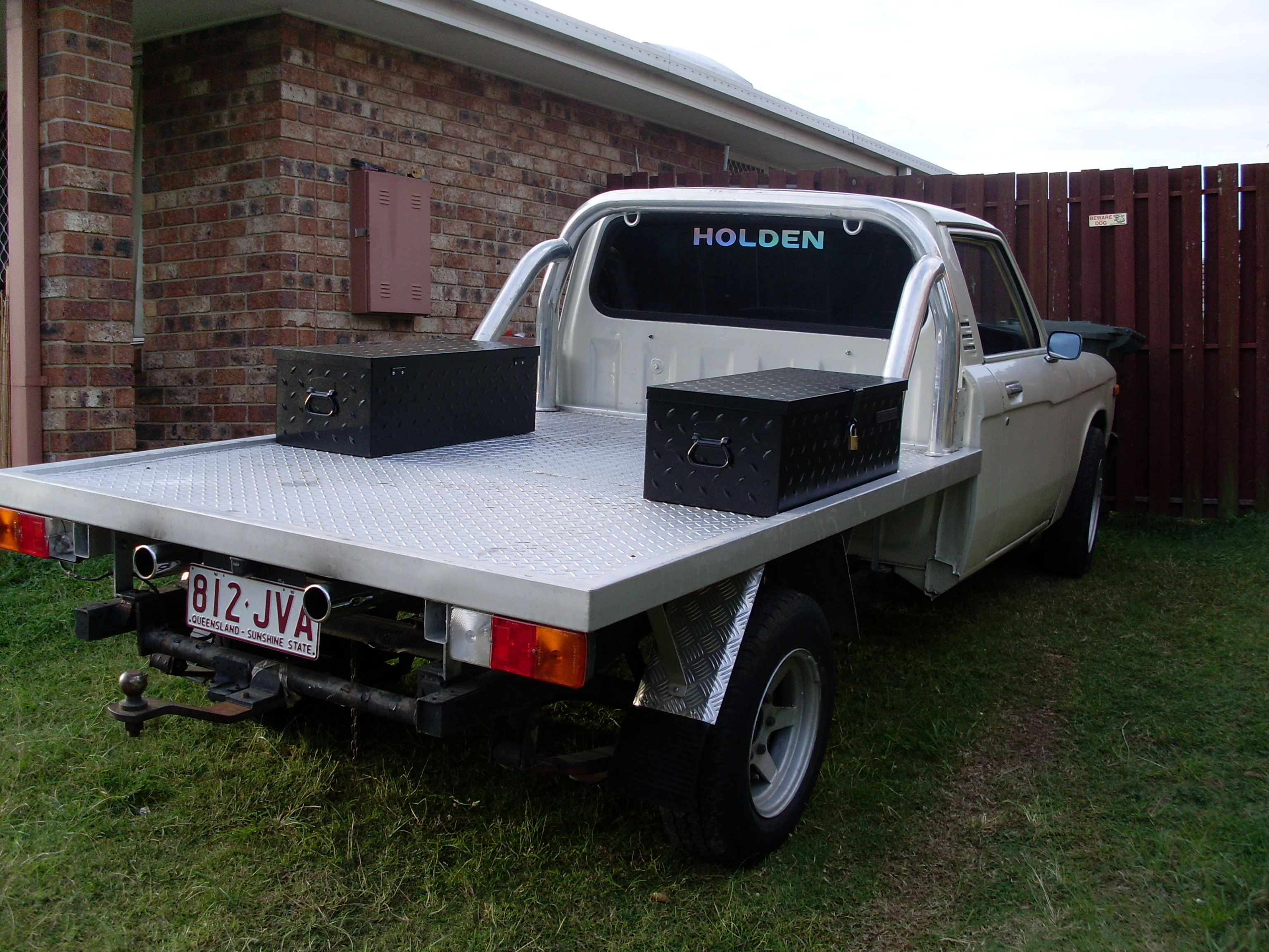

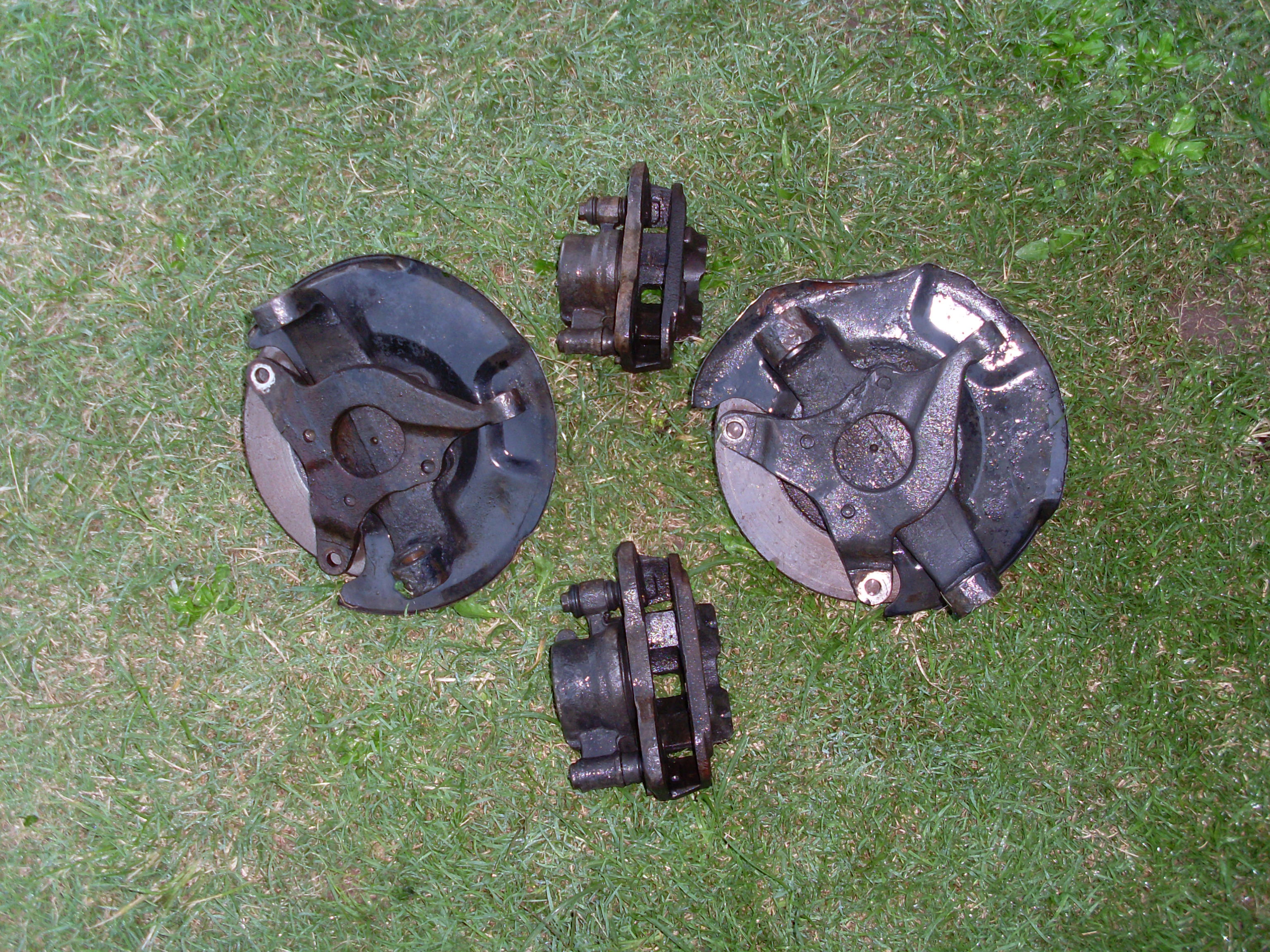

Hi everyone who assisted me in providing information and contributed to my conversion (thankyou so much esp. ozluvtrucker and roadshow bob!). To recap on what i went through: i spent over $500 (parts - 4wheel cylinders and labour) on the drum brakes to be informed (by 2 mechanics) about some issue with the adjusters not working and that you could no longer get em!
So this really pissed me off and so i went down the road of doing a backyard conversion to offset some of the labour costs associated with a qualified mechanic doing the work. The disks cost me $93 a side (they gave me 2 RH side calipers of a 1981 rodeo). the wreckers they had to order em from interstate and then ordered another left one and it was off a 4wd not a 2wd which is what i have, so eventually i got the right LH one).
Then I had to buy 2 new brake lines ($110). I also learnt a lot about how to break ball joints and tie rod ends and I tried the 2 hammer technique to no avail (plus you gotta be careful you dont hit the thread or bend it of then you will be in for some fun...! So i cant emphasize enough to get a PITMAN arm (Kinchrome does one) as this will save you so much time and frustration. I have an assortment of different balljoint pullers and it was trial and error.
Also in relation to the boots (grease filled platic type seals which lubricate the joints) and if you use a hammer to break ball joints you run the risk of piercing them (which is what i did and tore em to pieces) then you have to chase up new ones (universal ones from repco did the trick)! I also had to upgrade my master cylinder and absolutely shreded the nut that goes into the master cylinder and tightened it up with multi grips (through shear determination and frustration)!
And suprisingly everything is sealed fine with no leaks so far. In conclusion, i am by no means a mechanic (i'm a backyard mechanic) and it I am proof it can be done, but I was sure to always to jack the car up and place stands under it and safety, safety and more saftey should be applied as I did not want to injure myself (plus i left the jack under car and placed the tyres that came off under the car as added safety).
Plus overall this conversion has cost me close to $1000 Aussie dollars and it could have been half that price so if someone can get benefit out of my misfortune/experience then great. Also the Wheel alignment cost me $155 and would have been cheaper but something to do with shims (which needed attention) as the newer cars are easier to do and cheaper ($45). I was just happy to finally get my LUV on the road and just paid him and he could have had more after all i had been through...!
