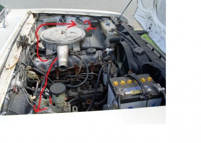

Shagg's, I visited your myspace page and checked out your pictures. I now know why you have to pull the wire to stop your Luv. The wire in your Luv has been disconected from its solenoid, the wire in the picture(#1) should be hooked up at position (#2)
HERES SOME PICS OFF MY ENGINE BAY

The previous owner most like'ly made this mod because the solenoid no longer worked.
