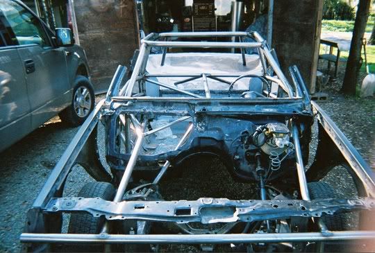

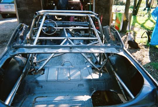

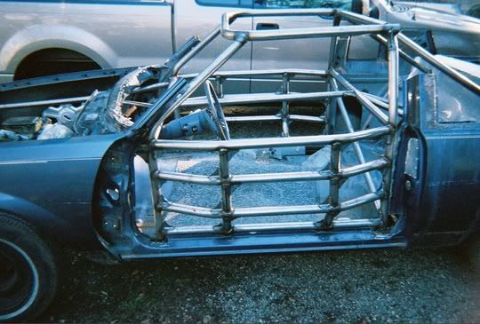

Hey Derek I just learned how to post pics on here and found some pics of the cage in my last car I built.

Looks good , also looks like a heck of a lot of work! Is it me or is the halo bar out of whack? By the way (sent you a pm) I now own a engine hoist as of last night. It folds up and it works great! had to load and unload five motors this morning with it.

yeah the halo was out of whack I ordered a kit from speedway motors that came with the halo, door bars and the main hoop. Most of the pieces werent bent right or even or a little bit tweaked. I didnt follow the recomendations like level the chassis first like I should have either, the car wasnt even close to being level so I didnt realize it was out of whack until I rolled the car out of the shop. I fixed it up right before I welded the roof on and painted everything. On top of that I did every thing myself. LOL you should have seen me when I did the door bars I had a come along and some rope holding it all together so i could tack it together.
