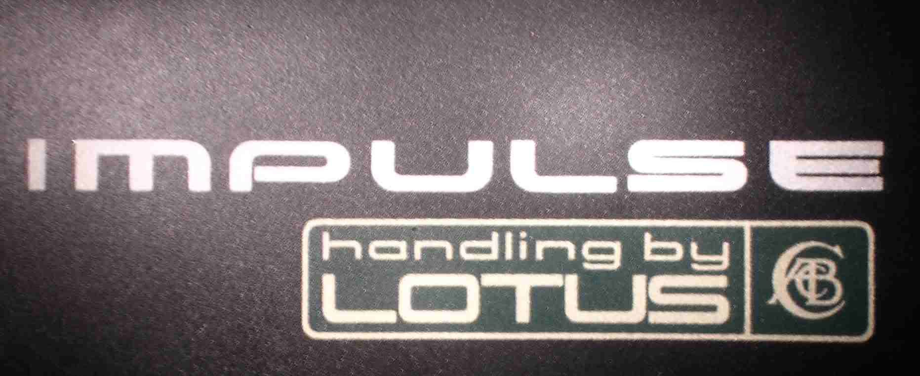

After kicking around in this car I have decided that I will have to own one someday. The whole dash setup is just killer, controls for everything right at your fingertips. The Lotus suspension looks like it would handle like a dream. Turbo or non would be ok, the 2.3L is only 30HP below the turbo and I could always drop a 2.6 in it. Better yet I buy a turbo with a blown/tired motor and bolt a 2.6 into it. That should be good for close to 200 ponies and the bigger motor with a small turbo should be almost lag free. Oh yeah, I think I will need to own one of these cars someday.
