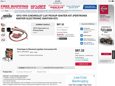

PostPosted: Wed Apr 08, 2015 9:26 pm
I found this, verify the number with Pertronix before ordering.

Thanks. For some reason I had it in my mind that the whole distributor housing would change. My mech suggested changing to a hotter coil as well.
Ill give em a ring tomorrow.

So.
I called Pertronix. It turns out that the distributor on this one is a double point distro. Pertronix does not make a kit for it. They said they will build one custom for 300 bucks but that means I have to send it to them.
Anyone have any thoughts or can point me in the direction of finding a single point distro that would work to I can just buy the proper kit for it?
Any other thoughts or ideas?
