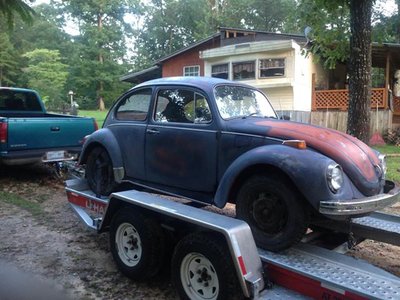

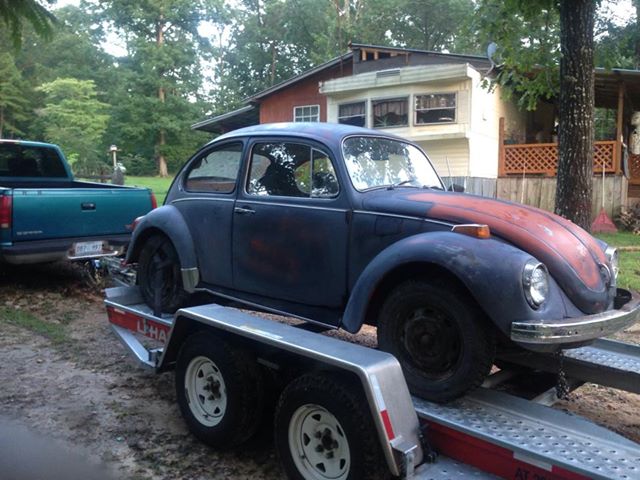

My son just turned 13. He'll be driving in just 3 years. Found a pretty cool deal on an old beetle. Rescued it from redneck hell. Hoping to teach him the value of sweat and elbow grease. Hopefully he'll treat it with respect if he has to work on it to get it running.
1971 Standard Beetle. 1600 DP engine. Body and interior are in surprisingly good shape. Floor pans are rusted to hell. We've got 3 years.
Almost had it running today. It tried
