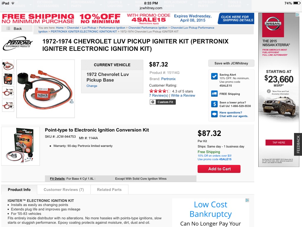

PostPosted: Wed Apr 08, 2015 9:26 pm
I found this, verify the number with Pertronix before ordering.
PostPosted: Wed Apr 08, 2015 9:46 pm
Joined: Thu Sep 18, 2014 9:18 pm
Posts: 5
Thanks. For some reason I had it in my mind that the whole distributor housing would change. My mech suggested changing to a hotter coil as well.
Ill give em a ring tomorrow.
