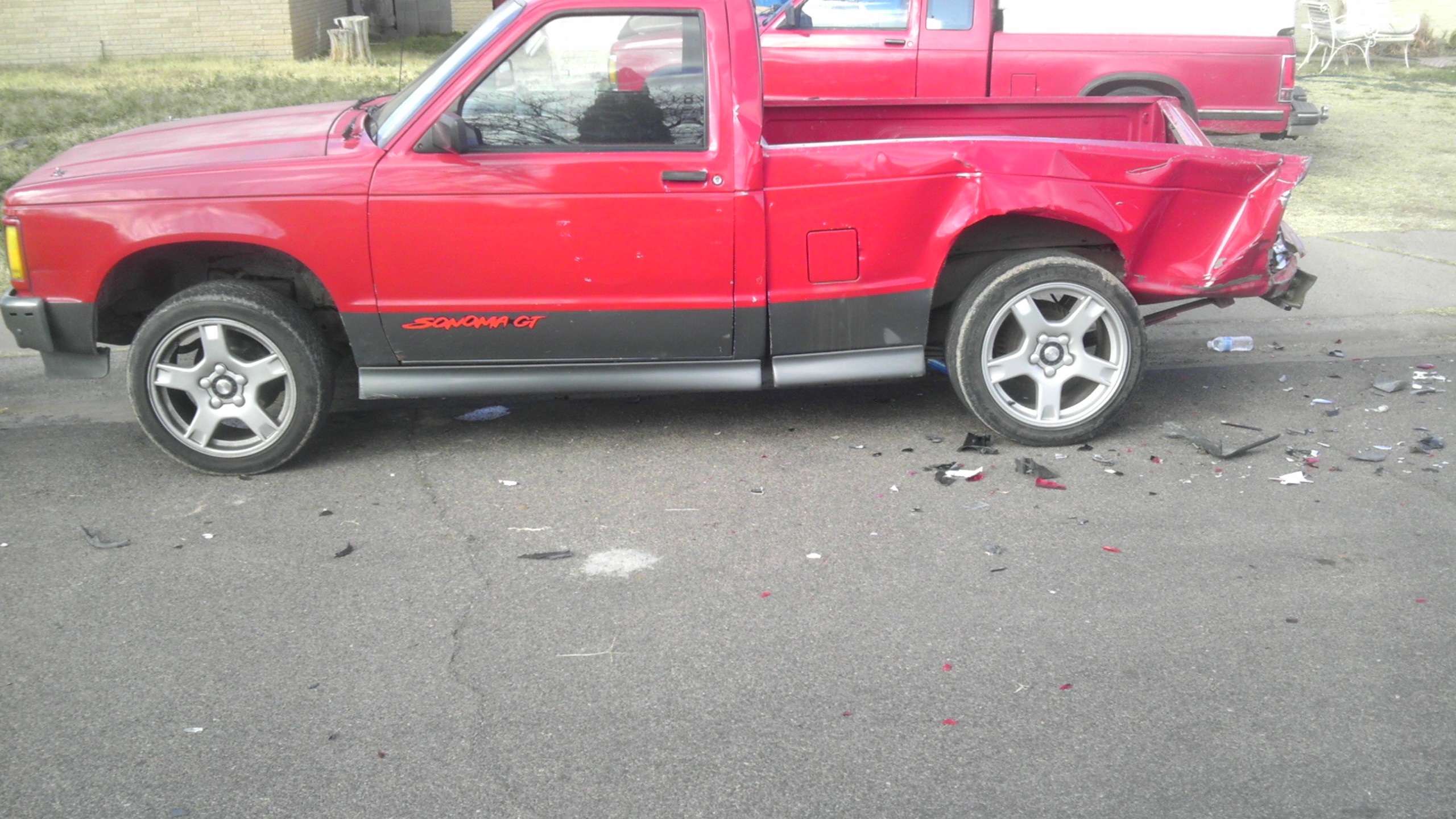

anybody ever successfully pulled their own frame? local shop wont take the job because they arent confident itll pull back true. also the shops in my area are really bad about only wanting big money jobs so i think i wanna give it a try myself. its a 92 GMC Sonoma GT. i have an extra frame but would like to keep the original because they only made 806 of these trucks and want to keep all the vin #s matching. my frame is true from the front horns til dead center of the cab where it has a pretty bad kink then its true again from the start of the bed to the rear bumper mounts. my truck sits almost 3 inches higher on one side because of this. i have nothing to lose so if i bend it the other direction or hurt it some other way im not worried about it. looking for any advice or old school techniques.
File comment: i have put a different bed on it it but you can tell the direction and force of impact from this photo

The only way to do this right is to take the whole thing apart.
Make a cheap chassis jig. I have made them with unistrut.
You can use the extra frame and create reference points.
This will require heat, leverage and clamps.
It can be done.

i like the way you think!!! i get so tired of hearing its gonna be "hard". i guess my idea of hard is quite a bit different than others cause just about every "hard" thing ive done was better described as "time consuming" and those people are described as "lazy". 90% mental 10% physical i always say.
i need to put another rear cab skin cause the current one is beyond repair, body mount bushings, and a crap ton of other small "time consuming" things on it. itd be easier with everything off anyways. right now all of my major projects are on hold cause i am in the process of moving back to east TEXAS. good news is that ive already rented a 6000 sq ft shop with a built in apartment there in Greenville so i will have all the space i need to work on my personal projects INDOORS!!!!!!!!!!
another thing tell me about this unistrut you spreak of.

A small amount of heat is perfectly fine. Especially with a torch. I'm not talking turning it to molten steel.
Put on a little heat, manipulate and let it cool down naturally. Your risk is higher making a heavy pass with a welder than a little heat from a torch.
There is no real "Temper" in these chassis.. Not like your thinking. If there were. They would shatter.
A chassis is designed to flex.
A "cold" pull can sometime be the worst thing you could do. When you make a cold pull the metal that is bending becomes hot from the friction.
The surrounding area is not normalized because it happens so fast. This can create a fracture that you wont see.
That is until you put a load on it later. By then.. Its just too late.
