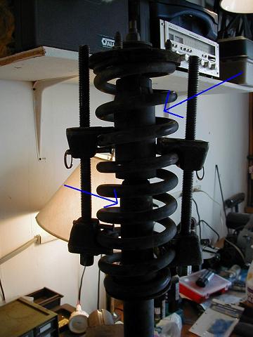

on my 02 toyota tacoma i have coilovers. now, can i change the shocks that are in the coilover, or do i have to change the whole thing...

yea just compress the struts, and replace them. should be no biggy. most good auto hobby shops have a nice screw press to make those coils easier to pull off, but the way your doing it will work.
A.j.
PostPosted: Mon May 04, 2009 4:59 pm
some parts houses can do it for you. Also check on the price... sometimes there is not a lot of price difference buying the whole thing.
Almost looks like a MacPherson strut.
