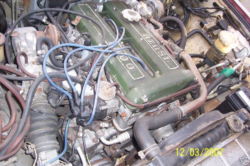

There is an Isuzu DOHC G-series 1600W/1800W/200W that was optional in RWD Japanese Geminis.
A few made it to AU & NZ.
Totally different from the 1.9/G200Z but if you wanna pay shipping you could probly source 1.
Try elky or Poida
http://workshopmanual.org/twincam/
