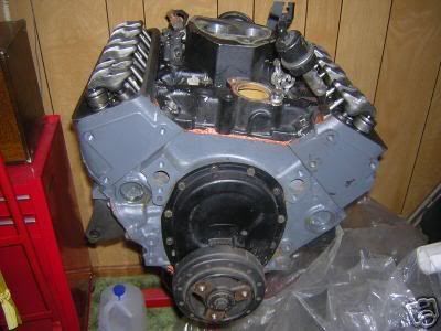

My full size truck has this motor but i dont know if it has a balance shaft. I've seen stuff for the Z motor 4.3 and sometimes they reference with or without a balance shaft.
Is there a way to distinguish one motor design from the other.

the year of it . and the timing chain cover. is 2 ways to tell.
this 1 has the shaft in it.

Thank you!! That's exactly the info i was looking for. I got the conventional looking timing chain cover so now im sure that i dont have a balanceshaft.
I've ran across stuff for the 93 year motor and it calls out a Z motor and i've seen stuff for both with or without a shaft.
Either motor has a roller cam (which cost as much as a short block kit) so now im in a better position to replace the cam.
