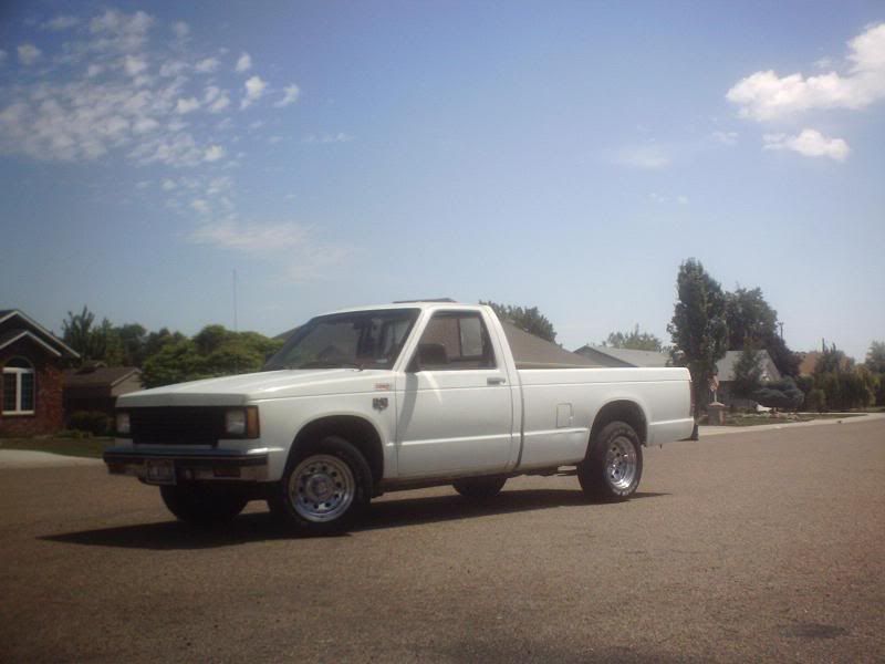

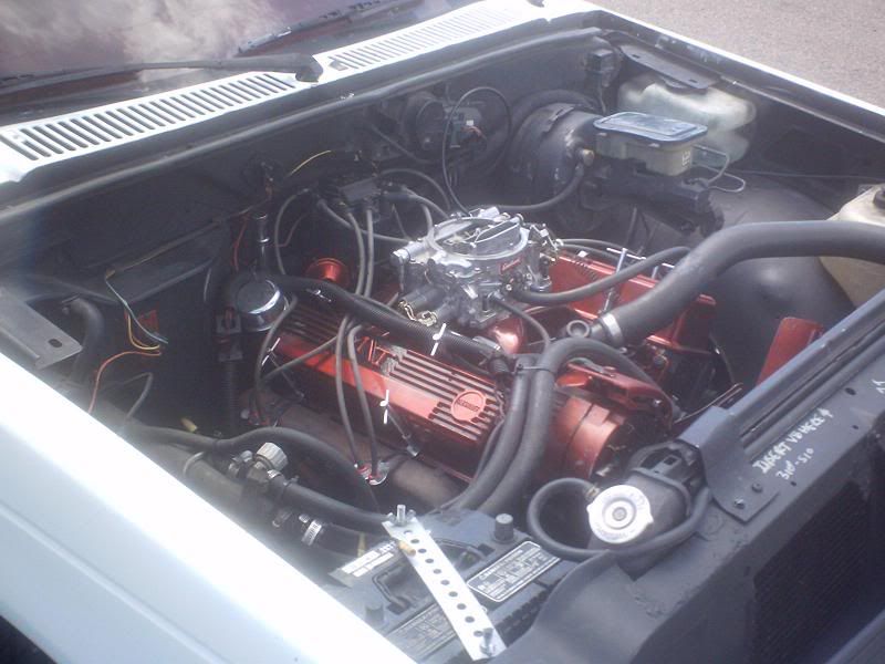

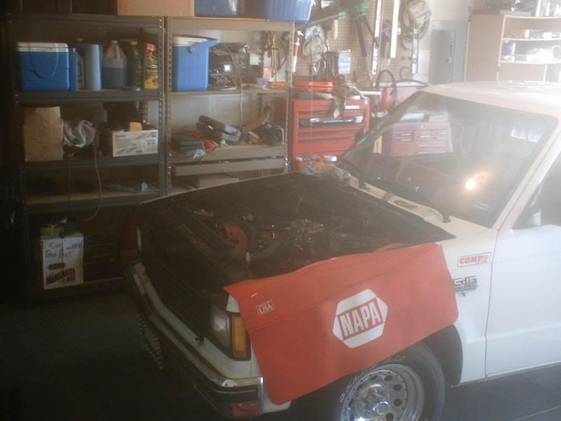

well me and a friend of mine finally got his 305 s10 finished. we put the 305 in it about 2 months ago, but the motor had alot of miles and had never been rebuilt so the motor took a dump. so we rebuilt the motor last week and gotit put in. weve put about 150-160 miles on the truck since saturday. heres some pics

Nicely done Neil 8)

must be nice to not have smog nazi's to deal with... nice job on that swap

Good job. That S10 has a little more room for that sbc too compared to a LUV.

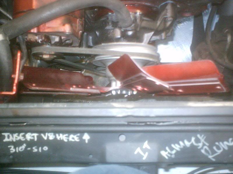

yeah its not too bad on space. the driverside exhaust manifold almost touches the steering shaft, but not quite. when he gets a set of headers for it the clearance problems go away.

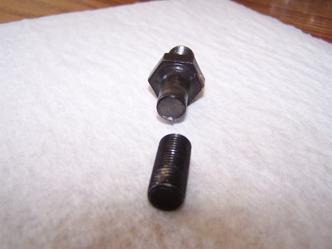

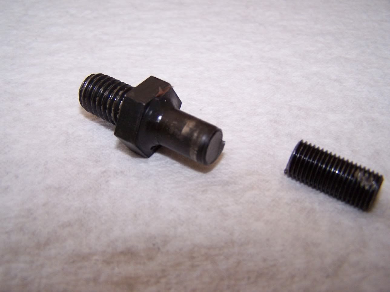

well well well. took the valve covers off of it this morning to find the screw in stud that was put in, was broken. dont know what happend with it either. so we went to the machinist and he gave us another stud to put in it.
i dont think the cam is flat now either. i dont know about the oil though. when i dip my finger in it, it looks clean. it does have a slight metalic tint to it though.
another thing thats concerning me is the oil pressure has gone up. at idle it use to have 25-30psi and now its at 45-50psi at idle.
so i dont know what the hell is goin on with this thing.
oh, heres some pics of the broken stud.
