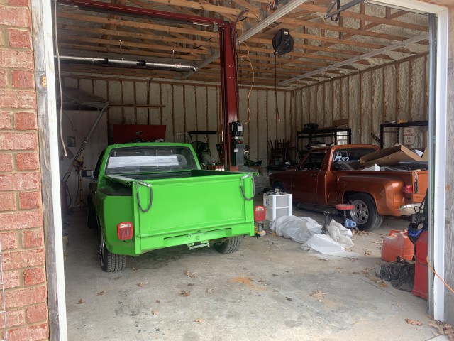

It’s fun to drive. Once we get the speedometer figured out dad will take it home. For now these guys are reunited and chilling in my shop. (Ignore the stuff in the luv bed. I’ve got about half of a 66 mustang back there while it’s at the body shop :p )
