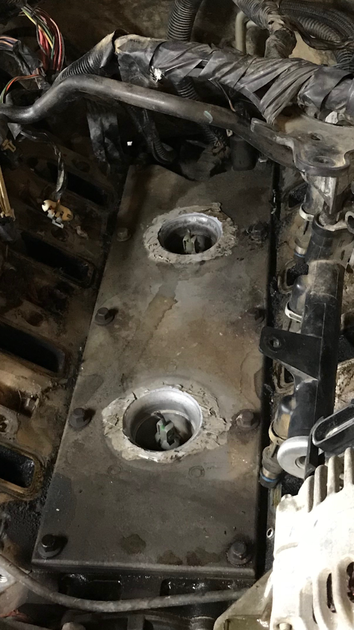

Oh I meant to post this. Look how close the wires got chewed to the sensor. You could barely see the wires sticking up through the covers.
