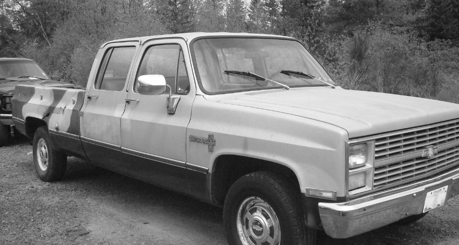

I'm looking at an '83 LWB, Crew Cab, C20 Custom Deluxe. It's a stripper, only a very small amount of cab rot in the back corner on the DS. It's got a V8 with a HUGE Edelbrock carb on it, dual exhaust and new tires. 4 speed manual trans.
I need a little help identifying the engine, most of the truck is in faded silver and primer and it's obviously not stock. There are no labels under the hood anywhere. I'm pretty sure it's a small block, but I'm not sure if I'd know a big block if I saw it. Is there a quick way to tell them apart, besides the size of the block? I feel sort of stupid for asking, but when I went to look at it, I had no frame of reference. That engine bay is huge.

This one is a small block, 2x4. Custom Deluxe C20. I think the C20 indicates it's a 3/4 ton?
Is the limitation in mileage related to the gearing? Obviously, no amount of improved engine efficiency will overcome that...I need to look at some theoretical numbers in combination with the 4 speed trans.
How do I check the numbers on the rear diff? Is there a code I can pull from somewhere? Anyone got a link to run the numbers? I know very little about differentials, and nothing about chevy rearends.
Waiting to close the sale on one of my vehicles and I'm hoping to cinch this truck. If this flies, then I can sell my utility trailer too, and eliminate a lot of clutter in my yard. lol...
PostPosted: Sat Jul 12, 2008 7:37 pm
The rear will be a Dana, most likely. The C20 disignated it as a 3/4 ton. If you can look at the rear axles, look at the flange where the lugs are. If it's flat like a passenger car, it's a Dana 60. If it has an extension with a ring of bolts on the end, it's a Dana 80. The sticks usually have 3:73's sometimes 4:10's. The autos usually have 4:10's, sometimes 4:56's. There are always exceptions though. Most of the time, the gear ratio is in the assembly codes in pasted on the inside of the glovebox. This assumes the rear hasn't been changed. IMO, the mileage will have to be lived with. The trucks are geared low for towing.

My other truck is a '82 Sierra K2500, over the years I've done a bit of research on the 73-87 Chevys.
The 5 speed you want to look into is a NV4500, the 90s Chevy's had that.
The 3+3s had Dana 70 rearends. Big monsters because they are duallies. For axle ratio I would guess 4.10. You can get mileage with higher gears (3.73, etc) but you will be hurting in the power department...the crew cab has to weigh almost 6000 pounds empty. The C in C20 means 2 wheel drive, the 20 means 3/4 ton for Chevy. (10 means half ton, 30 means 1 ton).
If you haven't found it--the 4 wheel and off road magazine website at one point had a guide to buying 73-87 Chevys, with a lot of axle ratio, engine, etc. data. Their website has had a rework and I hope it's still on there.

Missed you mentioned a 3+3 but no dually--didn't know those existed, so I have no idea what the rear diff may be. Count the number of cover bolts to start, Chevy has a 10 bolt, 12 bolt, and 2 different 14 bolts along with the Dana 70.

I think I'll go out one more time and look it over again. Still undecided, it needs all sorts of nickel and dime crap. It would solve a couple of problems for me though...
The guy dropped the price to $595...
