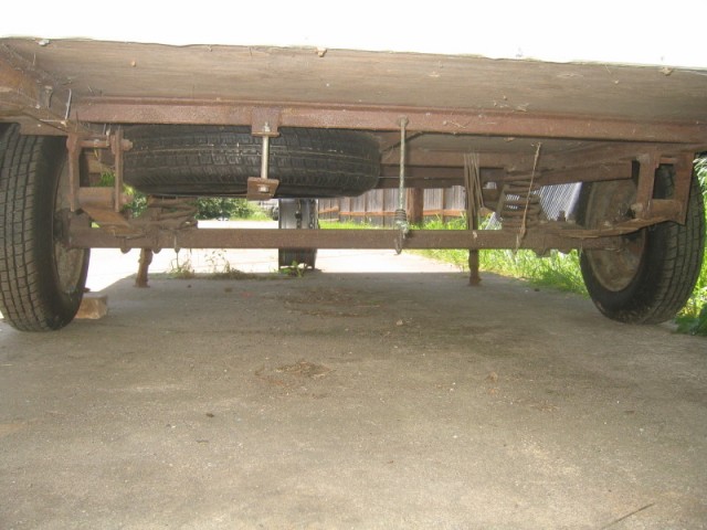

Our camp trailer is a home built thing with leafs, a trailer straight axle AND coil assist springs. The problem I'm having with it is suspension bounce. You'll notice on the right in this photo, the old (broken) tie wraps the previous owner used to try to limit upward travel. I'm thinking I may just use two short pieces of chain. I might add shocks, but I'm trying to keep costs down and can't do the fab work myself. Some sort of limiting strap or even a bolt on stabilizer/torsion bar is what I'm looking for.
Some of you folks are amazing with this stuff, I'd sure appreciate your suggestions. I'm not object to something light duty as this is obviously not a full time road vehicle. Fully loaded it weighs maybe 1000lbs. Honestly, I'd guess it weighs closer to 600-750 lbs with the tent inside, camp fuel, water and bedding. We carry most everything else in the tow vehicle. We take it out usually within 150 miles or so, and if we're lucky maybe 6-10 times a summer.

File comment: Tent trailer suspension
The bungee cord you see hanging is a securing device for some tent poles, it's not part of the suspension. :wink:
Let me know if there are better angles or something, I can get more photos.
Thanks for taking a minute to look this over, it gets scary bouncing down the road with this thing.
PS - Here's a photobucket slide show if you want to see the whole thing. This was homebuilt (not by me!) and tows like a dream. http://s5.photobucket.com/albums/y186/nukeday/Camper/2008/?albumview=slideshow

How about some shocks?

Hmmmm, shocks would be great if you could get short enough ones but would have to make mounts.
How bout maybe just taking the coils off and just use the leafs, i had a trailer I pulled a lawn tractor on with just leafs and it didn't bounce bad at all.
Or you could go with load leveler shocks and do away with the leafs but that would be a little costly plus fabbing the mounts.
PostPosted: Mon May 19, 2008 7:32 pm
I would say that the coils and leafs are acting with eachother. I would get rid of the coils.

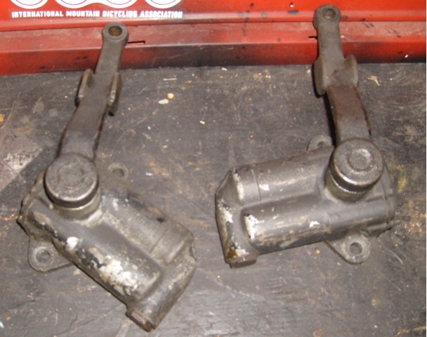

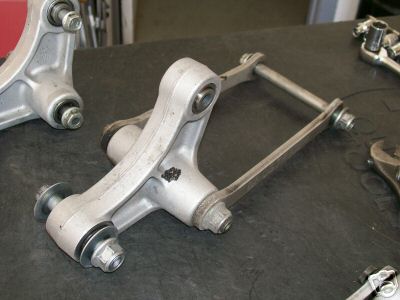

I'd like to keep the coils, I'm not sure what type of temper is left in the leafs. I'd rather have it too high than have it bottom out. I've been doing some looking at lever action shocks. I think late model motorcycle shocks, mounted inline with the axle might work.
http://cgi.ebay.com/ebaymotors/2006-GSXR-1000-REAR-SHOCK-LEVER-w-RODS-7-101-MILES_W0QQcmdZViewItemQQcategoryZ35592QQihZ012QQitemZ220235457751QQrdZ1QQsspagenameZWDVW
Maybe something off a vintage TR4?
http://cgi.ebay.com/ebaymotors/2-Triumph-TR4-4A-Lever-Shocks-Shock-set-of-two_W0QQcmdZViewItemQQcategoryZ34200QQihZ005QQitemZ150249397905QQrdZ1QQsspagenameZWDVW#ht_5542wt_0
Ideas?

Thanks for the suggestions. I've been looking at ATV shocks too. I like the automotive lever shocks for ease of mounting, but I'm still looking at all of the options. Mounting a mono style shock on a bolt of some sort is really a good idea. Seems like that would allow full downward travel and provide the upward limitation I'm looking for.

Coil Springs like that were add on helper springs, carry more weight, popular on trucks at one time. Maybe find a spring shop and get them to add a leaf or 2 to up the carrying capacity and dump the coils. I think both springs could be working against each other too.

I just rebuilt my trailer to handle hauling mt Rhino around. If your worried about removing the coils and the trailer not holding the weight, don't be. First I would remove the coils! Coils are a very bad Idea for something that weights so little. A coil acts as a slinky when not much weight is applied. (Have you ever seen a car with bad shocks driving down the road?). If the leaf springs have (3) leafs per pack they are usualy 1000-1750lbs capacity. Get the lenghts or take one off and go to the local trailer supply and beef the springs up to a 2500lbs. Or you can look on http://www.redneck-trailer.com/ for tons of spring spec's.

Thanks for all this info. I'll look over the leafs again, they may be fine by themselves...

I think the idea for the coils was to keep the tires from punching up through the wheel wells. I found some water damage to the floor on our last trip, so it looks like I may be doing a teardown this winter...
